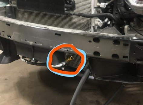

Car is currently at the shop right now having issues with KC install.
-Dodge couldn't recharge the A/C system since everything goes by vin/computer system - Wouldn't allow more than factory R123yf. Shop car is at now has to buy equipment to do older R134a. - Warned the seals and compressor may fail after 5 years with the older stuff.
-Killer Chiller location doesn't look optimal/off IMO. Installer said he put it there for cooling - Requested in the crash beam or under the light. I think it's blocking airflow, what do you guys with kits installed think? Need to move it?
Been playing phone tag with KC and the shop since they couldn't get in contact with each other.....not having a good time o_O
Last thing holding the car back from being home! Any help or knowledge is appreciated.

Not sure what this is going to or if it's just hanging there. My Drive - Google Drive - Google Chrome 10_27_2020 3_11_01 PM (3)_LI.jpg

With KC installs, the biggest mistake one can make is in choosing a shop who has never done one of these on this platform before.
With that said, that KC core doesn't need to see any airflow on it. In fact, it's blocking some airflow to the a/c condenser which is a critical piece of proper a/c (and subsequently killer chiller) operation. I have my KC installed where my auxiliary heat exchanger used to be on the driver side. I also bypassed the primary as all it does is fight the KC when it's setup properly. The KC has the ability to drop I/C fluid temps far below ambient and all the primary heat exchange will do is heat it back up.
Most folks convert over to 134a because it's easier to get, is cheaper, and has nearly identical operating pressures as 1234yf. Something to note, there will be a need to adjust the charge level up or down from an initial charge for optimal performance and I typically do this based on observed vent temps and I/C temps over time. If you have too much freon charged, it will perform poorly. Likewise, if you are under charged, it will perform poorly. There's a happy narrow range that you want to be in and that range varies from install to install depending on hose length and heat load on the system.

PS, that “thing” hanging is the TXV valve, it controls how much liquid Freon is allowed into the HX to evaporate and get cold in that process. If the capillary line to it is kinked it’s not going to work at all. Look at it closely for such. Also it’s sensor must be tightly up against the inlet chilled water line so it can control the Freon flow correctly. 87134DF3-036C-4E04-A456-733E6A99C8D1.png

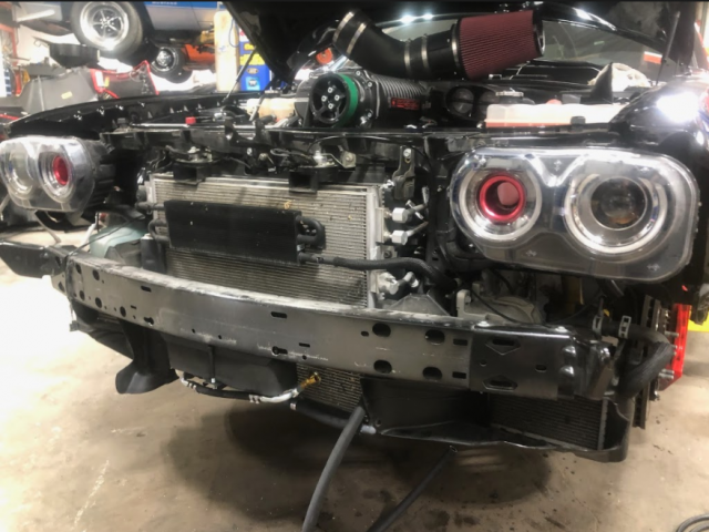

The installer wants to leave the killer chiller in front of the A/C condenser for airflow and to keep hoses facing down per Joe's instructions @ Kincaid.
I sent pictures of two other cars, one with the chiller installed under the driver light and another where the new coolant box is located now, so that's off the table. Shop doesn't want to put it under the light since hoses will be oriented sideways. Thinking cutting into the crash beam is the next best option. Anyone have ideas? Should have more pictures of the custom coolant tank setup later tonight.

Per Kincaid hoses can be side ways as long as Freon lines are on the bottom which they are mounted like I mounted mine under the DS headlight and hopper tank under the PS headlight. With insulation on them they fit on those spots snug and tight and the insulation let’s them float from vibration. No hoses, valves, nothing seen except for the insulated hoses in the bay to the back of the super charger.

I think were starting to get somewhere. Very happy with this layout now.
We decided to install a 2.5-3 gal coolant reservoir in place of the secondary heat exchanger.

Now that’s more like it!! Persistence pays off!! Keep on them!!

Hate being that guy telling them to re-do things but very picky with this car! Want everything done right. Hopefully install labor isn't too bad since they've never done a chiller before. Figuring 7-10 hours+A/C charging.
They just ordered the replacement Whipple parts this week after i spotted some things off in the second picture of chiller install which is odd..should have been done 6-8 weeks ago when i sent the email with everything listed out that needed to be done before it was finished being tuned. Probably have to pay $120 again in overnight shipping from Whipple since they're rushing to get the car done this week. Just like the last place that messed the whipple install up. De Ja Vu' .. at least this place seems to have a much higher level of craftsmanship despite lack of communication due to the owner being the only one dealing with customers. Can't say for sure though until the car is back in my hands for testing/fine comb through.:coffee::cool:
