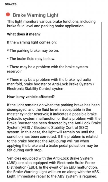

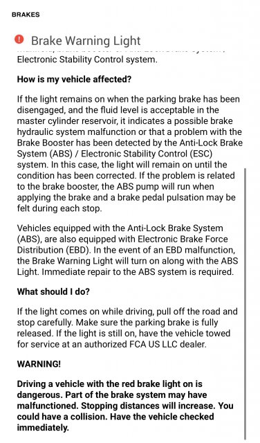

Anyone ever have a discrepancy between an issue listed in the vehicle health report and what you’re actually seeing in the car? Here’s my issue…
I get the monthly vehicle health report sent by SiriusXM and the past two reports have a warning with a big ole red “X” that says “immediate action is required”. The report says that my brake warning light is on however, in the car it’s not on at all. In fact the quick self check the vehicle does every startup has it come on briefly, then all required lights go out and indicates no malfunction(s) whatsoever. Furthermore, I’ve run the vehicle diagnostic from the dash display and everything comes back clear with no faults or codes. The vehicle health report says this warning is shown when the brake warning light is illuminated on the dash but as I mentioned, it is not, nor has it ever come on or been on steady beyond the startup self check. Please see pics below for a description of what causes this warning according to the health report itself. Though I have not looked too deep into the brake reservoir or ABS system, none of the issues listed apply in my case, but I’d imagine (assuming the info on the report’s description is correct) that I “should” still see the brake warning light ON in the vehicle. It is however concerning me that the warning shows up on the report.
I would assume if I indeed had an issue that the vehicle itself would be the one to warn by way of a light (stuck on) or some kind of fault code, since the SiriusXM health report is an optional, subscription-based service. I mean if someone did NOT have the service I can’t imagine they’d be SOL and left to find out about a fault the hard way. Am I off base here in thinking this?
I’d hate to take the car in for diagnostic only to have them tell me nothing is wrong and charge me for it too…
Anyway, thanks in advance for reading.
