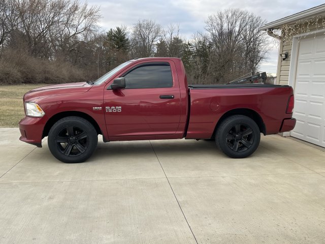

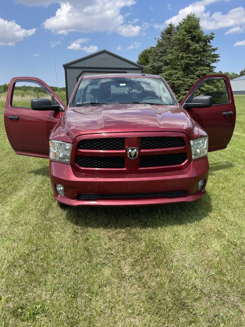

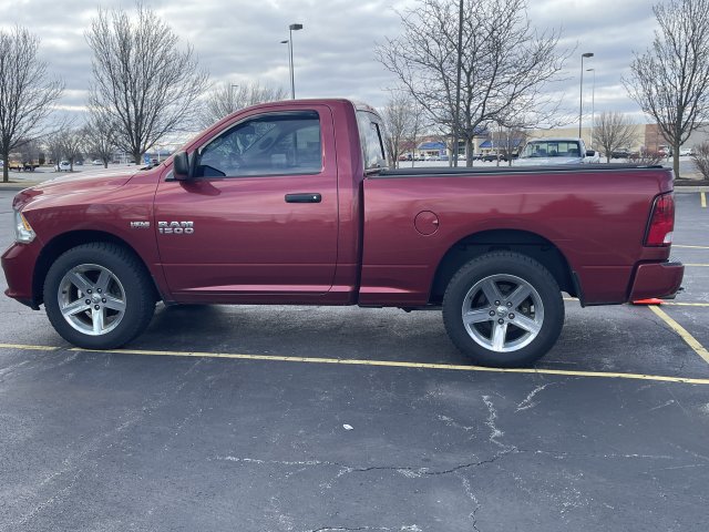

Current state with new hood and grill installed, the other pics are parts piling up and one with winter tires (original chrome rims) and one with summer tires (black factory sport rims)

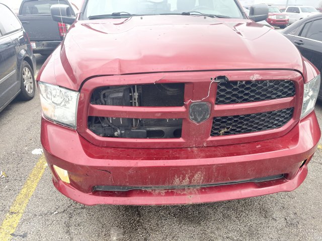

This is what it looked like after The Great Goose Incident and then my son hit a pole with it! I’ve changed the hood and grill out and have new bumper cover, bed (needs painted to match) and headlights
