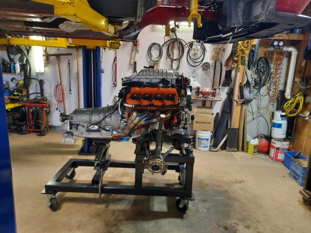

I`m getting my recall done soon going to walk into the dealer with my cats. the rest of the car will still be at home lol.

You got dimensions for that stand?
I'll like them if possible.

I know the service manager, he laughed an said ok . I`m only doing it to make dodge feel good an not send me any more mail.
:whistle:
I take no credit for the design @DemonSRT takes the credit but I did all the welding of it.
:whistle:
for sure!!
:whistle:
justed talked to @DemonSRT an as expected he has no problem.
tomorrow I will drop the car down attach cradle an take a bunch of pics an measurements for anyone who wants to copy.;)
it works fantastic.
there`s a separate support for rear of oil pan so you can remove trans as well.
