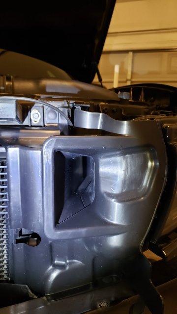

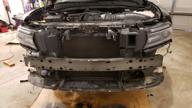

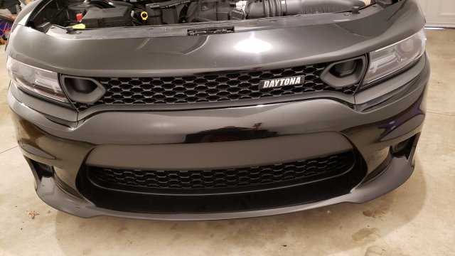

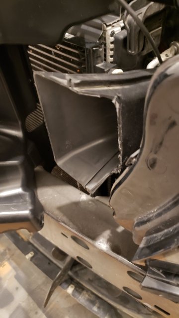

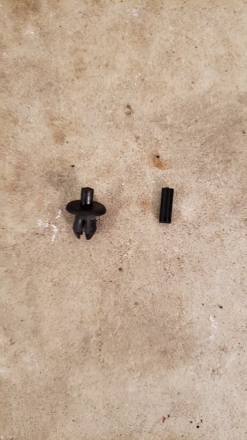

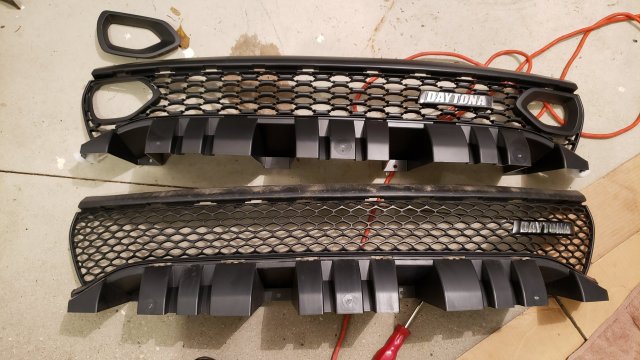

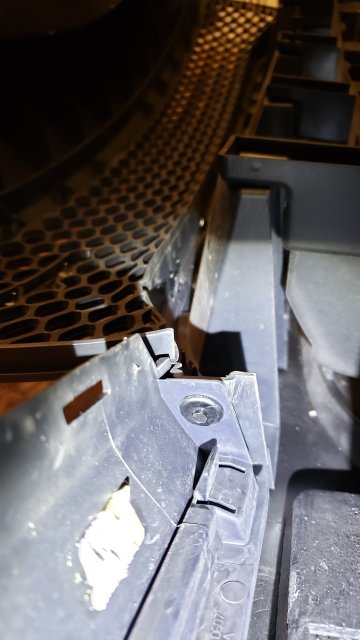

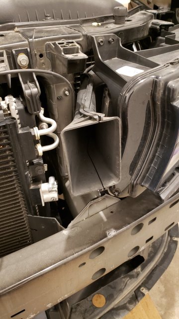

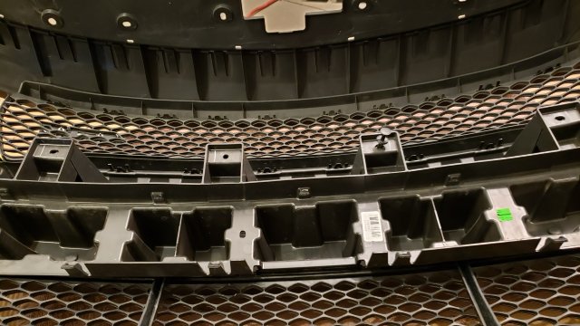

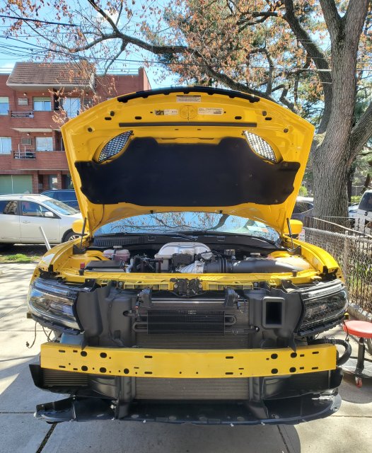

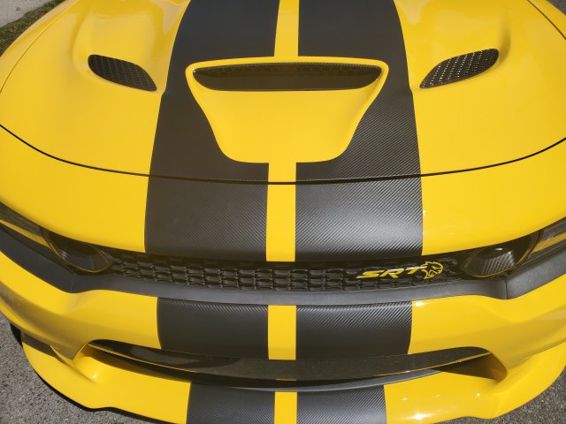

I did this write up awhile back and thought I would move it here. There are videos on how to remove the front so I'm not going to get into that. It took a little over 3 hours. The lower grille is bolted in so it went pretty good. The upper grille has tabs holding it on so it takes a bit to get each one unattached to get it off. There are also 6 push pins holding it on. There is a different kind of push pin on the lower part on each side. At first I thought it was a small bolt but there is a round plastic pin that I had to use a punch to hammer it out. Can't say I have ever ran across them before. I also had to cut a small part off my air inlet so the new radiator shield would fit. Using a cutting wheel it took all of 1 minute to trim it.

Total cost through Steve White was just under $200. I already had the air inlet so that dropped the price from someone that would need it. Here are some of the prices from Steve White

I just completed this mod this weekend.
