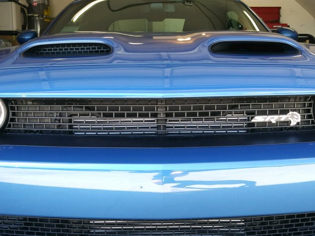

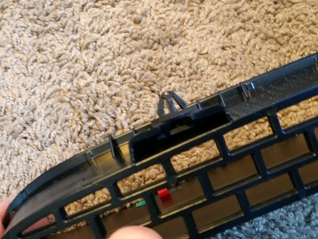

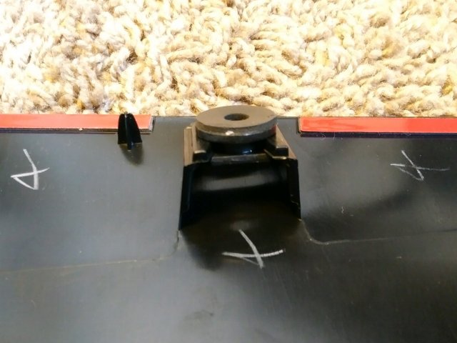

I will have one of these in hand tomorrow. I will take some pics for you. The 2020's have the Grill and they have a tower on the bottom where a bolt goes in to hold it in place. Kind of like a fail safe. 0503201510.jpg 0503201511.jpg

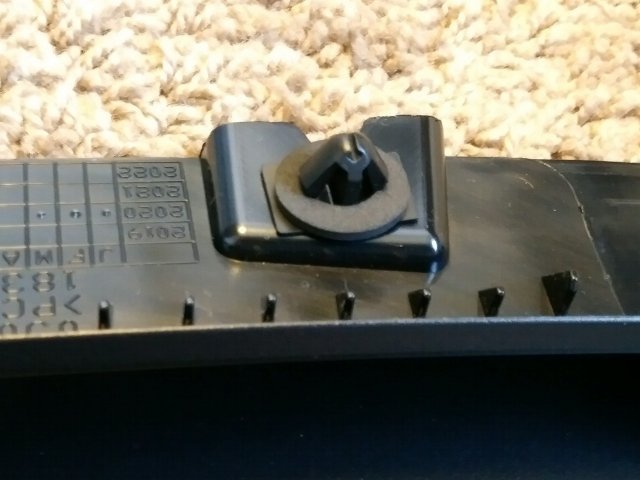

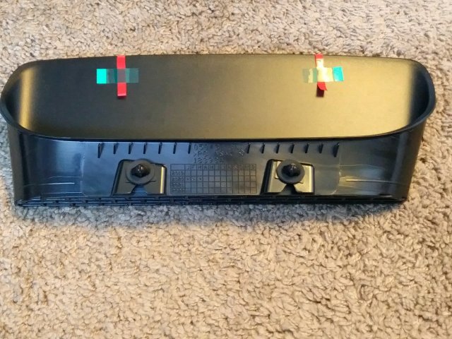

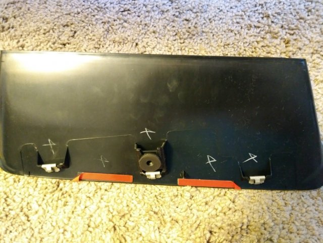

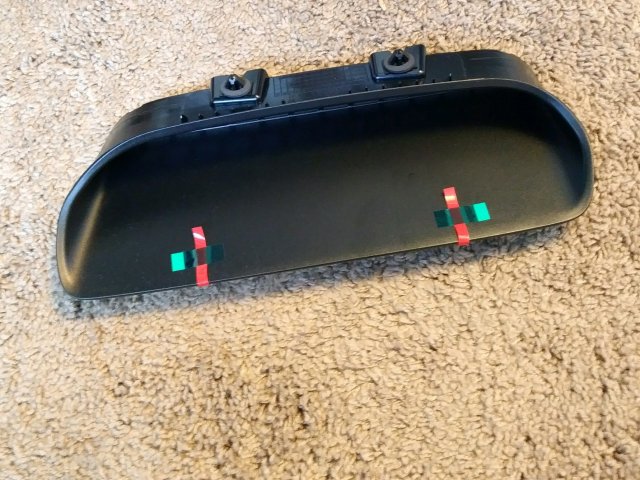

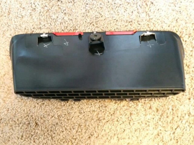

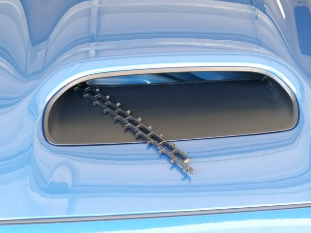

I was wrong about some things. These scoops interchange 19 and 20. So a 20 will go into a 19 car but a 19 car will not have the tower pressed into the sheetmetal under the hood for the bolt to go into and screw in to the nutsert by the center clip on the underside of the scoop. I see no reason why a 19 scoop will not fit into a 20 car as well. Also note the 2 upper clips that look like a Truss actually have a button head that snaps into a Key Hole Slot in the scoop. It's interesting how the scoop comes with those installed. To remove scoop from hood you pull forward and these clips will stay with the hood and pop out of the key hole slots. Simple, no?
. 0903201706a.jpg 0903201658b.jpg 0903201656c.jpg 0903201656a.jpg 0903201655a.jpg 0903201655.jpg 0903201654b.jpg

I did not see a hole for a screw on the bottom of my hood.
2020 only.

I beleive they 100% will. But a 19 will not have the provision for the fail safe bolt. If you look right next to the nutsert there is a silver clip (1 of 3 clips) that 19 and 20 both have.
Also be advised that right and left scoops do not interchange.
