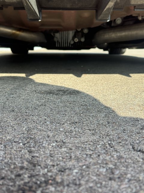

Rebuilt 3.09 LSD successfully installed on 23 charger rt. Carrier sourced from a 16 challenger scat pack

Nice ! 3.09 was the first mod I did on my 18 Charger R/T before it had 500 mi on it.. Diff came from my brothers 2015 SRT Challenger.. mandatory mod for an R/T in my mind.. enjoy !

I would have to agree. I have a whole new love the the car now and I’m only at 9k miles

You rebuilt the 3.09?

not sure what a rebuild looks like when you can`t get parts. at least nothing other than seals from dodge.

Correct you cannot get them from dodge. You have to either find a ZF distributor like Alto or get the pack out of another diff. Can and has been done extremely well.
