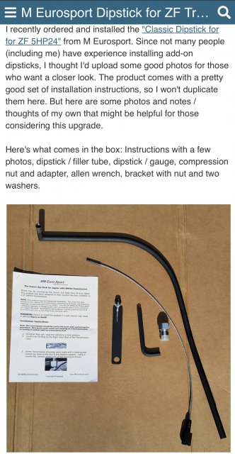

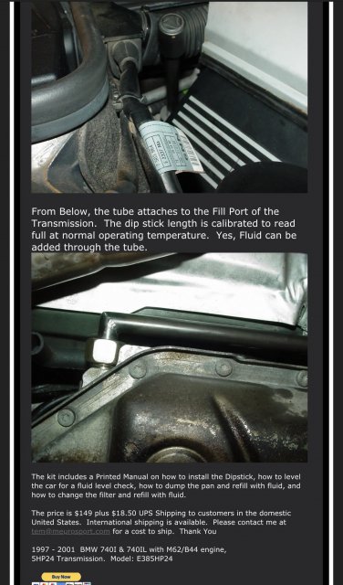

Fun fact, a company makes an aftermarket dipstick for the ZF in the bmw (also no factory dispstick) It’s just a tube that screws into the plug and goes up to the firewall. Someone needs to make the same thing for these.

If someone came up with a high-quality design for our Dodges', I would be a buyer x 3 in a heartbeat!

I wonder if a guy could design up a profile, and a really simple die-set and a 3D bend profile to follow, then find an OTS dipstick to combine along with it and then, presto!

I’ll take one please for whoever wants to make one. For as cheap as this one because it’s the same freaking thing.
