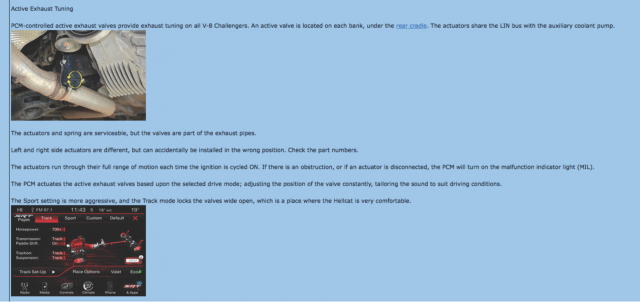

The sport setting is a little louder but track mode locks the valves open.
http://www.activeexhaustsolutions.com can help with keeping them open.
