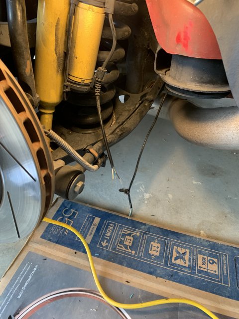

I found my wire on the driver side rubbed thru and I thought about just repairing it. But what I want to do is just replace it the wire is about maybe 2' long and there a connection you can unplug and the other it goes up to the top toward the shock...how it the heck you take the top loose? I felt up and it seems to have black rubber cover that the wire leads in to. Has anyone took the off before? Thanks

I used some waterproof crimps and some fusion tape stuff. But with the waterproof crimps that’s probably all you’d need with any good electrical tape

yep thats what I'm going to do I'll just solder the wire back together and use shrink wrap....I was just thought about replacing the wire from the connector to the shock. But your right doing what you done is just as good.

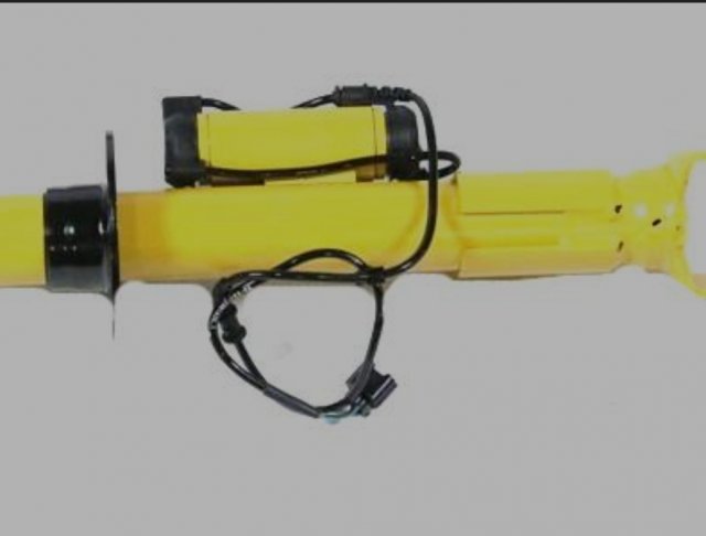

Rock Auto shows a new one comes with the pigtail, so I don't think you could easily unplug it from the damper body even if you wanted to. And the struts are about $600/ea so I'd definitely give splicing a try first.

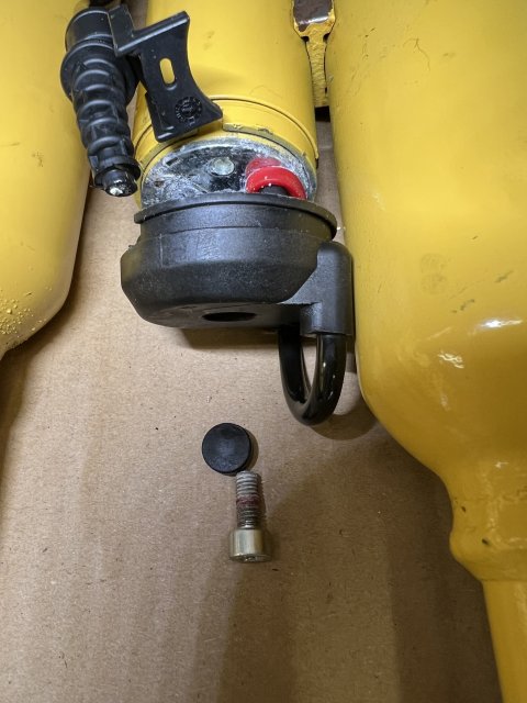

Thank you! Looks like I can reuse my existing stuff.
I'd found a set of struts/shocks off a 22k mile 2022 Hellcat to replace my 130k mile units. They looked great. So I snagged them. Later I noticed what I should have paid attention to before. They all have the wiring harness cut. Turns out there is a hidden screw under a cap. Wires use contact pins. So I can use my existing wires.
