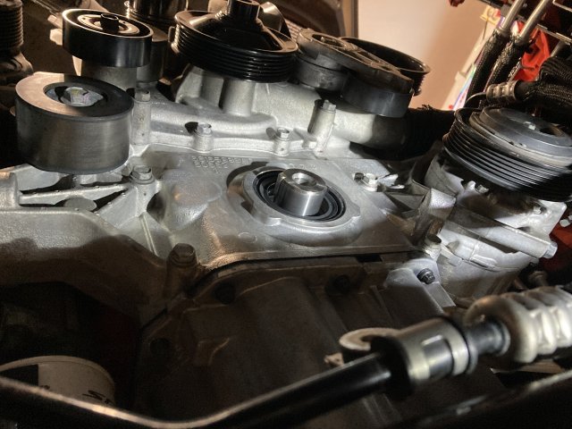

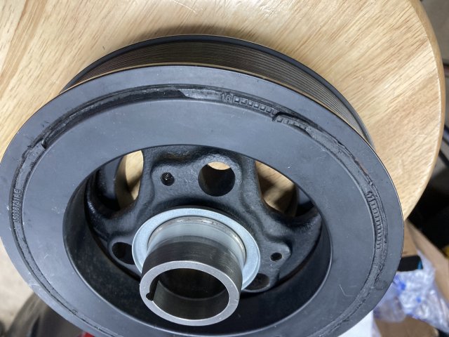

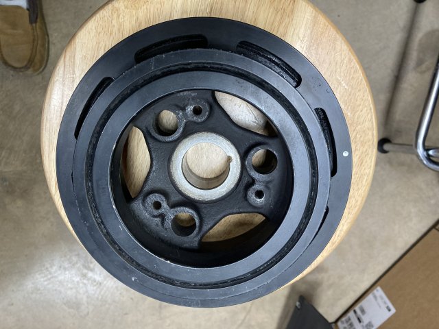

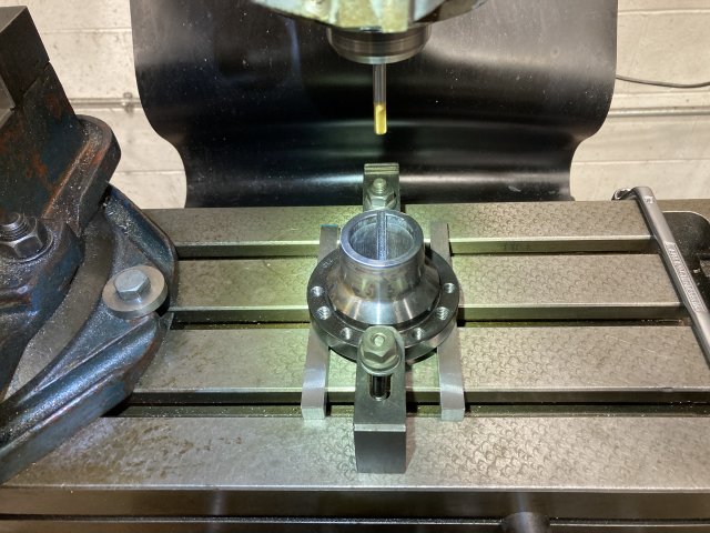

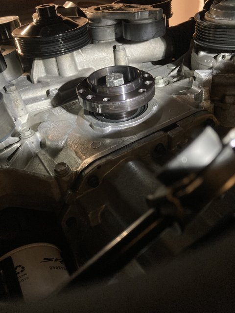

I just did this this weekend. Best thing is to machine the new ATI hub to accept a round key where it’s cut for a square key. I’m putting a stock size shell on for now, have a 10% OD and clearanced the AC mounting boss to clear the hub so it’s ready for quick swap between a stock size shell and the 10% OD one. 29B3C420-321F-4BD4-8689-9D3DA7F40178.jpeg 55864019-51E2-4059-A007-7BDE5EFF6AFF.jpeg 721DA250-0A95-4FAF-AC4E-6DB94890A74F.jpeg B4A59D61-C29F-4E14-9574-CB3BD05E75FD.jpeg 72CC556A-949F-47DB-9FF2-5C822203004C.jpeg DBB8609A-5138-4FA8-9C89-9756DEA849D3.jpeg

I doubt it. I do this in a milling machine with a 1/4” end mill. I can do a hub for for if you want to send me one. I would need to know the projection distance of the pin on your crank snout to get it right. The jig does not drill the pin hole exactly 50% in the shaft and 50% in the hub. Easiest and quickest thing for you to do is just mount it and redrill the crank for another pin but yes your crank starts to look ugly after doing this too many times but who’s going to see it under the bolt??? I have the Towing in the ability so that’s just the way I do it I did that to my stock balancer as well notice how the pin groove goes all the way from one side to another that’s how I was able to re-mount it in the same location as it came off when I rebuilt the engine. I cut the groove all the way through the hub so it could follow the existing pin onto the snout when being pressed back on.
