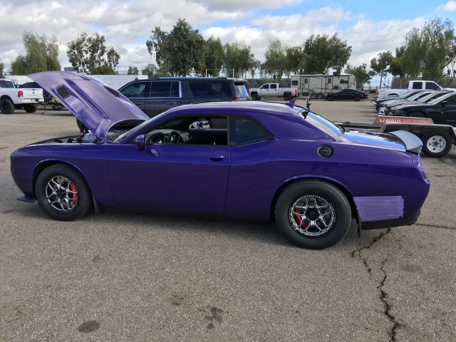

Hi all,
I need a new Trans for my 2016 Hellcat Challenger with all the common mods and tune for 950hp. Most mod work done at under 4,000 miles by reputable shop. Then upgraded to FF, dual pumps, etc. with one of the very top tuners. New SC and Engine and pcm/tcm tunes at 12k again top shop and tuner. Now she needs new a trans. after approx. 100 >9.9 1/4mi. passes and street driving, hot rodding around since normal 500mi. break in.
So, Here I am needing a new “Reliable” trans. I’ve narrowed it down to these options but just can’t decide. Reliability for 3 or 4 test n tune type events a year and otherwise street driving is my main concern, not best et. I would really appreciate some of the Forums hard earned advice. 🙏🏻
1. Take to the Dodge dealership and have them R&R with NEW OEM trans.
2. Take to local trans shop for R&R, with NEW OEM trans.
3. Take to local trans shop for R&R, with trans from D&B ‘Hellno’ on the forums (either the 8HP Extreme 8HP SS) or other shops ‘built’ trans.
4. Let Race Shop do the Work.

Thanks to everyone who encouraged me to use D&B Automotive in Memphis! If you haven’t checked out Davids videos on FB and Youtube, you should!
David, thanks for the help deciding on your 8HP90SS Trans with billet drum &hub upgrades. It should be on its way to you from So.Cal. by the end of next week if all goes well. 😎 I’m excited to get her back on the track and see how deep into the 9’s I can go before getting kicked out of the stupid NHRA Tracks here in Cali! 😡

Thread Starter #20
It started with a 3-4 flare. Then, strangely enough it would shift to 8th whereas prior to that it would never go into 8th on cruise control or on the freeway in sport or track mode. It would throw codes and then towards the end the speedo wasn’t working right, etc.
