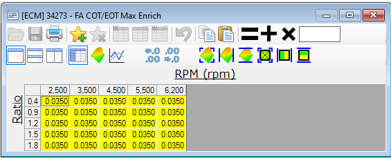

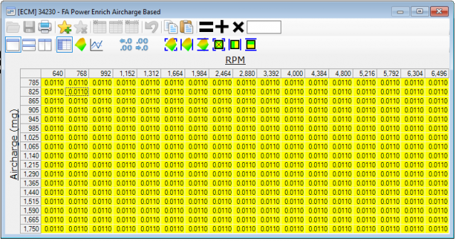

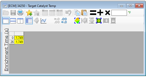

Here are a few screen shots from a 2020 Redeye factory tune file thanks to @DRAGRCR for sending it to me.

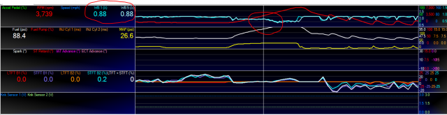

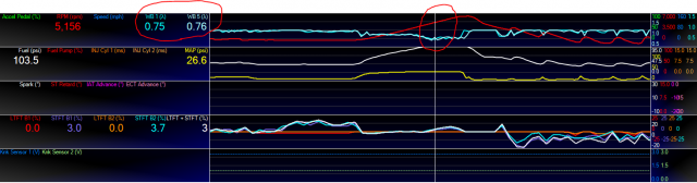

Finally, here's a stock Hellcat on the dyno. You can see where the Lambda starts off around .88 (12.1 AFR) and then suddenly drops to .75 Lambda (10.3 AFR) as cat over temp protection kicked in. That's a bit overkill on the fueling during COT in most tuner's opinions so that feature is usually disabled in a custom tune (mine included).

The PE (Power Enrichment) table using either Aircharge vs RPM or PRatio vs RPM. Which is added by the stoich value. (Does anyone know why the Aircharge and Pratio are different?)
Breaking down stoich and power enrichment
.0722 Gasoline Stoich | .0110 =Aircharge vs RPM PE table
So
.0722+.0110=.0832
1.0/.0832=12.02
To find commanded you take 12.02/13.85=.87 Remember the 13.85 comes from 1.0/.0722=13.85
