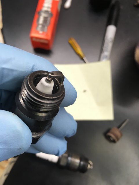

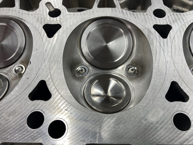

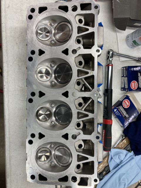

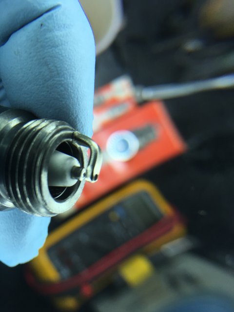

Index? Yes lol, me, always lol Facing towards the intake valve to cool the electrode and keep plug clean from shading of the electrode by the ground strap.
I’ve gone a step beyond and have drilled ground straps even to start the kernel and prevent spark blow out with nitrous lol
