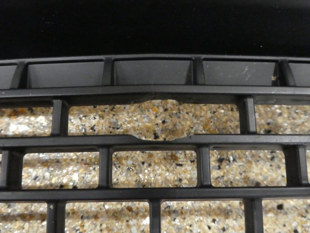

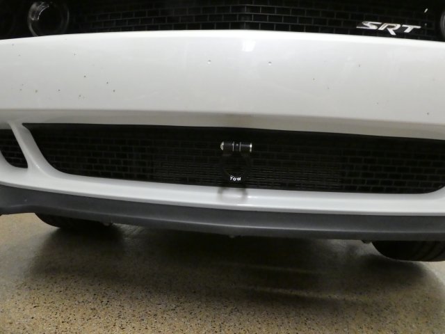

I have ZL1s. Can do the front without removing the fascia (just the lower grill insert) if you are patient, careful, and have a very short right angle drill and bit. Some say it's easier to pop the facia off, but I decided to try it first without doing that - was successful and looks great - cannot even notice the receptacle at quick glance - only had to trim one of the small vertical slats to provide clearance for the hook.

That's why I tried it first without removing anything - I could locate fairly precisely where to put the mount with Sharpie marks without having a big hole in the grill insert - tradeoff for that vs. ease of drilling the mount holes by popping the fascia off.
I have the rear one too but have not installed it yet. I also bought a set for the Charger but have yet to install either one on it yet. The instructions for the rear are a little sloppy on exactly where to cut the hole in the fascia - I have two different instruction sets from ZL1 that are slightly different - that's one reason I got a little scared and put it on the backburner. I do not know if they have improved them any or not as I bought the first set for the Challenger about 6 years ago.
Thanks! I'll see if I can borrow and angle drill. Front is definitely preferred.
