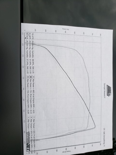

innovators west lower pulley 13 psi
93 octane bp
stock injectors
hp tuners
car drives like stock , until the accelerator is mashed.
309 rear differential
all work performed by modified by kc
733 & 670 to the wheels
