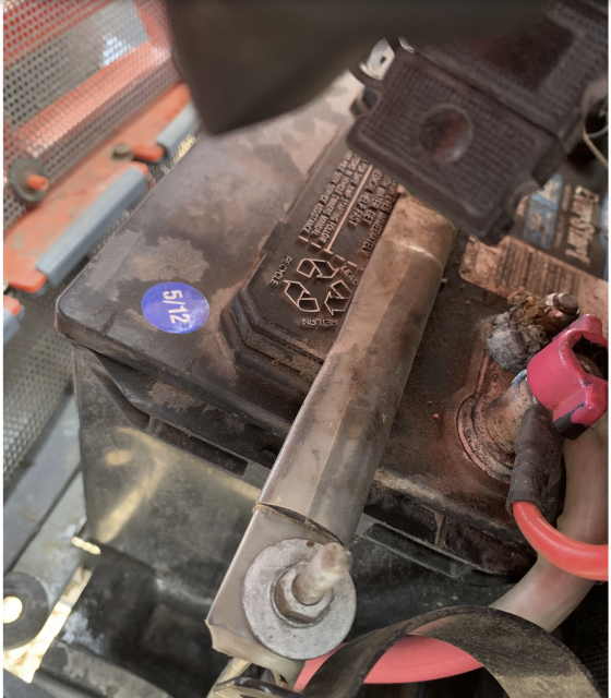

I said this in another thread. I have been using HF cheapos for maybe 8-10y. I have not replaced a battery since I started using them. I really like the newer ones they came out with recently, maybe $16 on sale. My Bobcat has a 2012 battery and starts great after sitting all winter. These things are magic!
