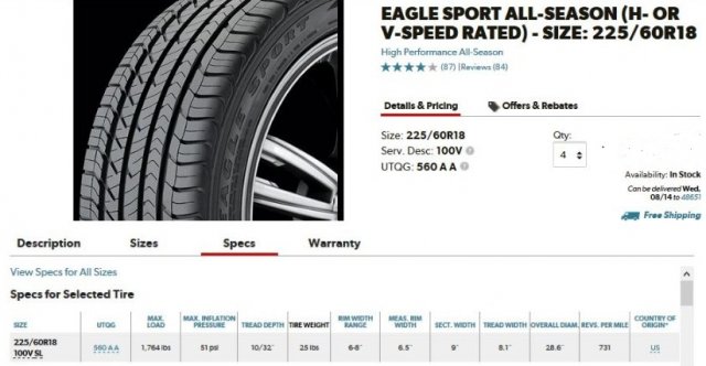

Does anyone with the 18 x 6 Weld 2.0 Alumastars over a big Brembo stock setup use a wider front tire than the typical skinny? I am looking at the Goodyear or similar 225/60R18.
For limited street use, more rubber on the ground. Also, I have to drive 100 miles on the expressway to the track. Tire in consideration is 28.6" tall and will fit on a 6" wheel. (My rears are 29 tall 305 MT R's) Note the specs on the bottom of the photo.
I would like to see front/side view photos of the 225/60R18's on a Narrow Body car with Alumastars, if possible.
OR MT 28" S/R #6688 photos as well. Plan B. Again, on a narrow body.
They weigh 25lb's same as the 28" tall MT S/R #6688 skinny. I will never exceed the V, 140 something speed rating for what I will do with them in the quarter mile.

They have a hard compound I notice. Not sure if that is good, or potentially bad.

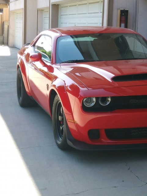

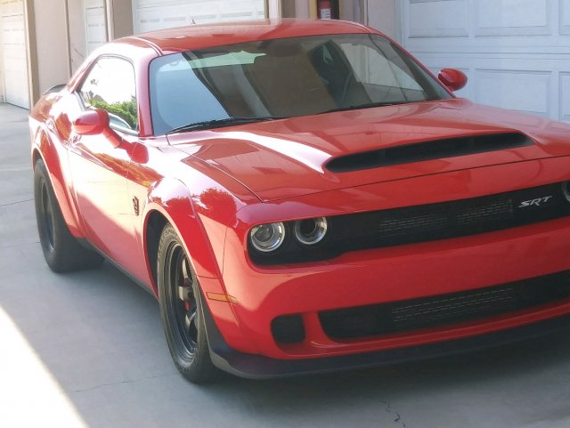

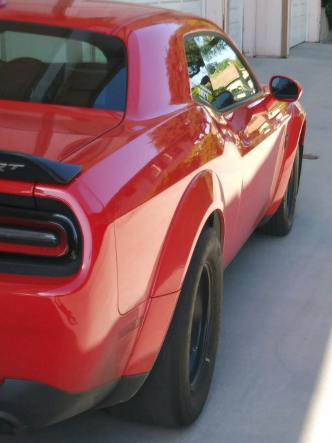

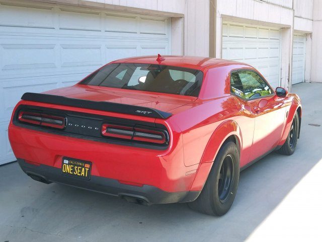

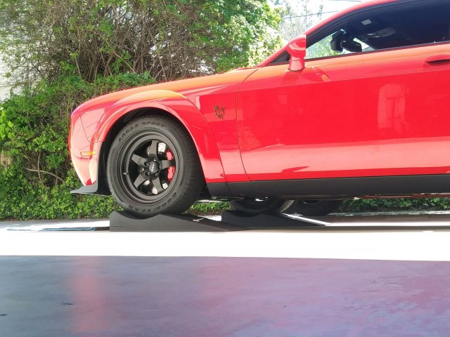

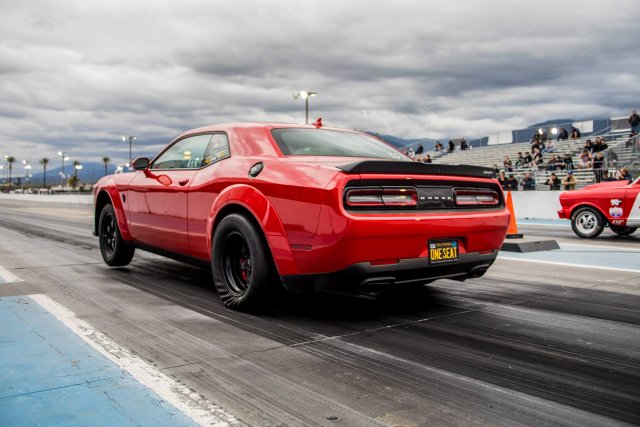

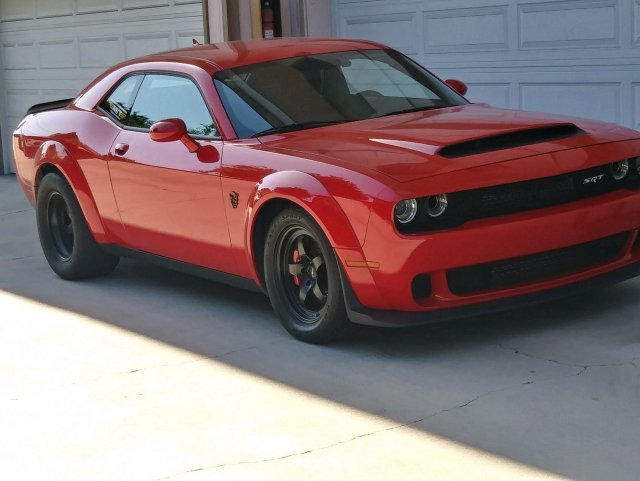

I have run that exact tire on my Demon on a 18X6 wheel. In fact it is the same weight as the Mickey Thompson Sportsman SR skinny (which is heavy for a Skinny). But the Goodyear will 100% drive better. I have driven BOTH setups because my Friend stretched the Sportsman Skinny on the very same rims and I drove his Demon to get rid of fuel so he could blend his octane up to 100 to run the 840 mode. He told me to drive it like I stold it. I like the Goodyears much better.

Dang thanks for that info. Don't make any special effort, or any effort at all if you don't feel like it, but if you happen to think about it at some point snap a photo from the front, maybe off to the side just a hair so I can get a better idea of how much the sidewall bulges out and I will try to picture it on a NB. And maybe a couple more but no big deal. Thanks again. EDIT and great photos BTW

Great photos and info. I appreciate you taking the time for this. I see these Goodyears have over a 500 treadwear rating if I remember right so they must be somewhat hard, but obviously you don't have any trouble stopping or anything else. I need to find the weight, and offset of the typical NB Alumistars and then do what you suggest, and that is picture them on an NB. One more question....Would your S-71 18 x 6 fit over the large 6 piston Brembos ? Seems to me they won't . Reason I ask is that I that have S71s 18 x 10 with black centers in the rear. Thanks

They will not fit a Hellcat. I have been 140 mph on them at the drag strip and they drive really well on the street. That is in fact my street setup. I sold my OEM Demon wheels and tires a while ago.
