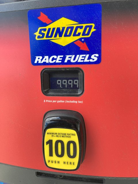

So, now I have Stage 2 installed, every time I want to get full power I need to drain the tank and put in 100 octane. I was thinking it might be nice to just run 100 octane all the time. I don’t use it much so the extra cost is not that horrible ($9.99 vs $4.60/gal). Am I hurting anything (besides my wallet) doing this?
I was thinking maybe using octane booster which would result in about $6-$6.50/gal but then I read reports of plug fouling and suggestions that is is not a good idea to run booster on a continuous basis.
Anyone have experience with either of these?
Though I appreciate all the opinions you guys provide, I would really like to hear from the “been there, done that” guys here.
Thanks!

YOU THINK I'M FUNNY!!! :ROFLMAO:
17,281
54,075
I'm completely jealous that you have it available at all, regardless of price.
Must be nice to live up there in the clouds, with all of the amusing people.

That is a good price. The guy from vp I talked to said ms109 is good for about a month in the tank. I’m no expert but I suppose you’d be ok as long as you keep filling fresh unleaded race fuel. I’d still run some 93/tune or whatever premium you have periodically, but that’s just me. I have to order my race fuel and it’s $117/5gal:eek:

We have it here in WNY as well....it's been the same price the last 3 years....9.99...in more than a few places
