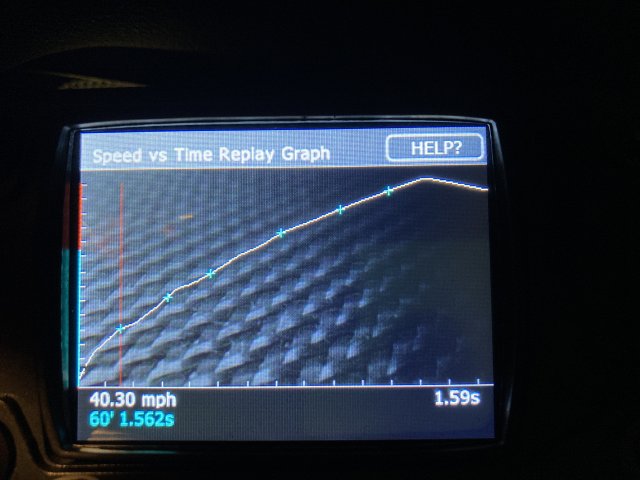

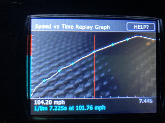

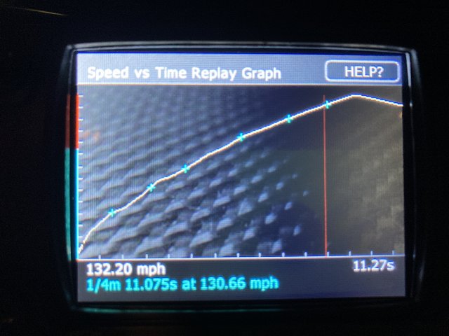

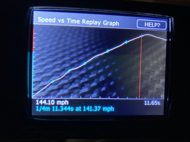

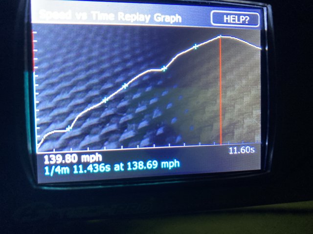

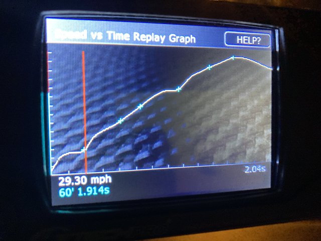

I keep a detailed log of every 1/4 this car has ever run short of instrument malfunction where except for car data data wasn’t captured. I even set my Gtech while at the track and record runs for comparison to track data, the Gtech always within a few hundredths if not closer to track marker times. What I’ve noticed is 1/4 end mph is always about the same no mater if I’m on the track or the street, I use it as a judge of HP being made and it rings true most always. Even if I have shitty launches on the street (usual street 60’ varies from 1.950 to 2.400 and make a big difference in ET but not MPH) my 1/4 mph never varies much, DA makes more of a variance in top end mph then my 60 ft times on the street verse the track do, I track DA with every run as well. Just my observations of 3 years of trying to run 10 second street 1/4’s. . Here’s a prime example of ET verse MPH on the street. This is a 1/4 run on 93, the HP is not there but I hooked excellently due to perfect clutch throttle interaction, closest I’ve come to a 10 second street run so far. It’s too cold here now for good ET’s, I’ll do 141-143 1/4’s in this cold (30F) air but times will be high 11’s. I also use my 60-130 and 60-140 times as a judge if tune changes are making more or less power. The Gtech (and I use a Draggy too to back up the Gtech, I find the Gtech more accurate to track timers so I use its data predominantly)
The 11.4 run produced a decent street 60 ft time but hitting second gear spun like mad and spun again on the 3-4 shift (dips in the graph) spoiling what would have most likely been a high 10 second street pass, that was on corn. The 130 mph 11.0 pass was on 93 where the lower power and tq of 93 made spin control more manageable and produced the best street 60’ I’ve ever logged on the street, if the top end power of corn was there for that pass that would have been a mid 10 second street 1/4 no doubt. It’s a tough thing being quick with a stick, even tougher to be consistently quick with a stick, but when you get it all just right it’s sure brings a BIG smile.

I guess what I'm saying in my mustang with a certain dr's I had to easy into it off the line, it wasn't a dead hook and I would run 142-143 mph. After changing tires to one where it hooked and I was able to add timing only under 5,000 rpm it was running 148-150. I was asked how I picked up so much mph and time and I said I was able to floor it and it hooked. Being you have a stick I know on the street you can't do that and would think you are slipping the clutch to get it to hook at the track so a dead hook foot to the floor would yield more mph
