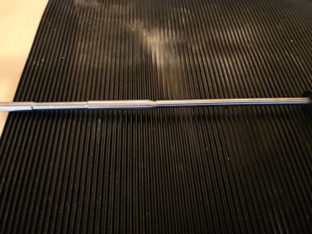

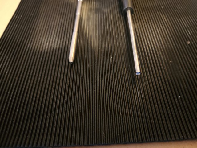

So if you're like me, and you're changing your pads every other day for a variety if reasons (testing, track days or even just for low-dust), it can be a PITA to strip your calipers down without nicking your powder coat when removing the pins.
I've long envisioned a drift pin that had a matching conical recess in it, and was also a bit longer than the typical drift pin or punch. This would allow you to knock the caliper pins out without worrying so much about slipping off of the pin
So this past weekend I got myself a set of long punches, and modified the 3/16th
(.1875") punch. (The front Brembo caliper pins are 6mm (.2362"))
Punches are usually pretty hard, so modifying them can be challenging, fortunately the set I bought wasn't super hard, so I was able to drill them successfully with 135° cobalt split-point bits. (Very low rpm!) I used both a 5/32nd and 9/64th bit, to produce a stepped feature that closely matched the conical nature of the caliper pin. Keeping the drill-spot precisely centered is important! Take your time.
So when you put this punch on the caliper pin, it "grabs" the pin!

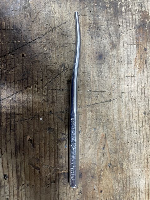

Everyone wants to talk about different handy items?
My favorite for getting around anything and using to punch the pins through initially in order to release the springs. Old punch that fell to bending years ago and now has risen to one of my favorites for this and sometimes the AAD hole line-up feat.
View attachment 84452 View attachment 84453 View attachment 84454

@jroyk I bought one for $30 a few years ago, the end of it mushrooms out. I think it was represented to be titanium. Doubt it! Typical cynize chit. I have filed it many times. That is why I like my trusty old bent punch.
