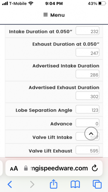

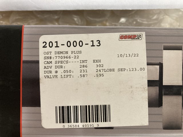

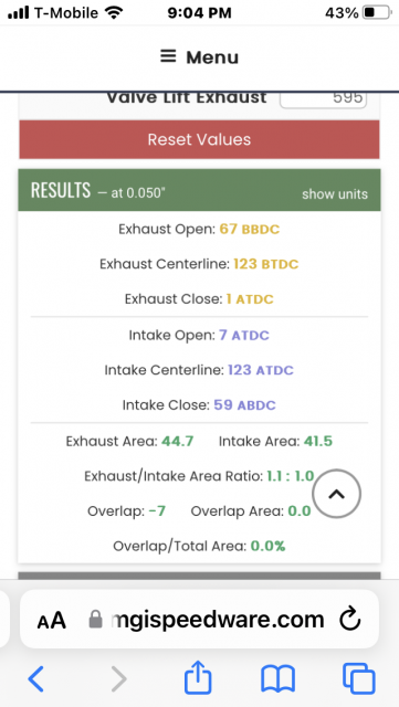

OST’s Demon plus cam is close to Indy’s
AB253886-3609-404D-ABDB-D6EF5FFB77B1.jpeg 296E08A3-BCF2-412D-95BB-209F92237C1B.jpeg
Good amount of lift, not much if any overlap, a bit lumpy sounding still, good mid and top end power cam good for ported or bigger heads and blower.

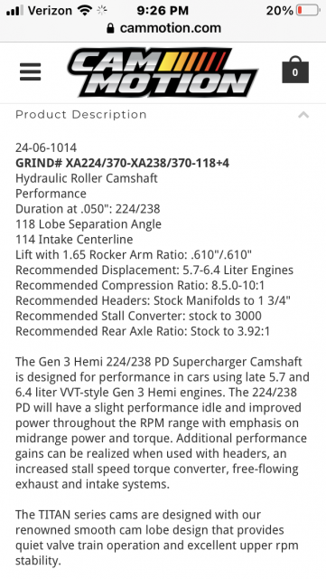

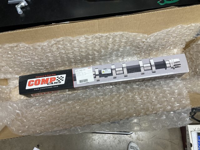

This that cam, it’s a good grind for big boost with big intake valves like in the Thitek heads
BB8FE748-034B-4B57-9211-C55CE8ED1C0A.png 2BB8CE2D-55BC-454A-B355-526C80FE6B31.png
3,571
8,427
This the cam Cam Motion suggested to me to use on my first build. I wanted to keep VVT so I didn’t go with it. Probably make 40-59 or more hp with it.

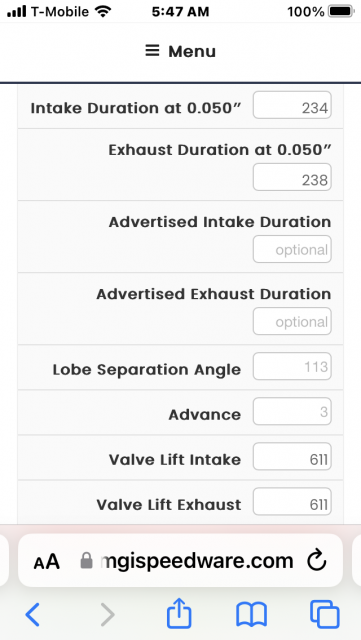

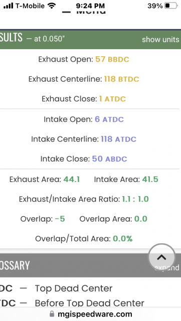

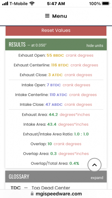

I'm also looking in to cams.. the guys at Tapped performance has their RedEye Rumble that they recommended to me with my stock displacement build. Leaning towards this cam and the 2.200"/1.65" dual spring thiteks. 234/248, 611/611. Sounds absolutely wicked
3,571
8,427
I bet it does sound wicked but allot of overlap for a blower cam, you’re going to be blowing boost right out the exhaust. Based on specs given Not a very Street friendly cam IMO.
2EBBAF3E-7E5D-4AE9-A426-F6AAB50CAE6D.png D87A96F2-921B-487C-837F-9A098AA127E4.png
4,362
10,840
if Lsa is 113 like @16GoManGoHC2 is showing you won’t be happy

If there is overlap in this cam which there probably is with a lsa of 113 you will probably lose power. For street ability I think I will just stick with the Demon cam.
3,571
8,427
It’s what I run and what the Drmon 170 still runs, one of the few carry over parts from the demon engine. Millions and millions spent on R&D and they kept the cam exactly the same for some good reasonS I’m sure.
