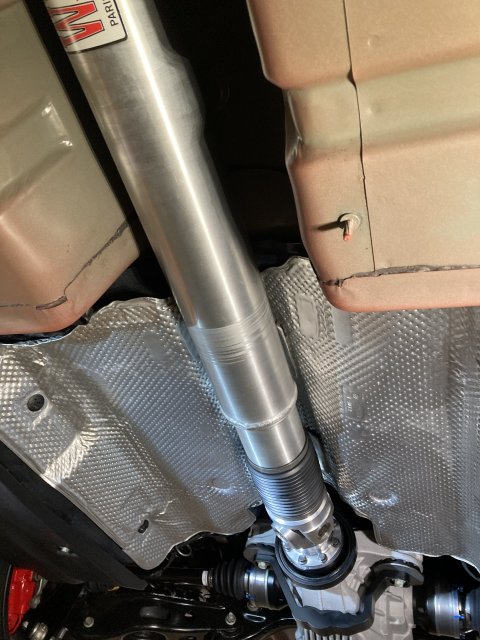

Update, I decided to go with a Wiles after bending Ralphs ear on the phone for 20 minutes. 4 inch aluminum tube, foam filled with u-joints and Sonnax flanges. We will cross the interference issue with the Barton when the time comes.

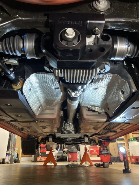

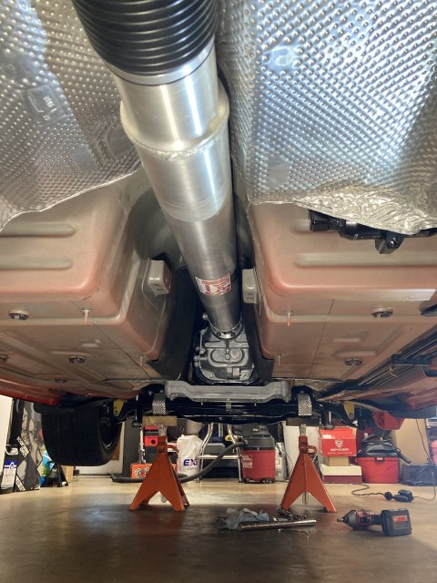

Just to wrap this thread up the drive shaft in. All good! I had to pull it out two or three times to fit it but we’re all good. Got it only up to about 85 but no vibrations. You could see on the weld exactly where it was hitting the shifter and it left a mark on the shifter as well. I just hit those areas (on the shifter, didn’t touch the ds) with a grinding wheel for a while. Took off enough material to clear it, and when I took the driveshaft out for the last time in order to put Loctite on the bolts I hit it one more time. Only problem I couldn’t properly torque them down as I couldn’t get a torque wrench in so I just tightened them up nice and firm. 👍. Not a tough job at all, just a little tedious but if you guys don’t have an issue with interference between the Barton and the d/s, it’s a bunt. R&R the exhaust is cumbersome with one person but dooable. Two people would be a big help. Thanks to @Speedy! as I usually check his yt page before doing a mod that I don’t feel like bumbling my way through. 🍻
