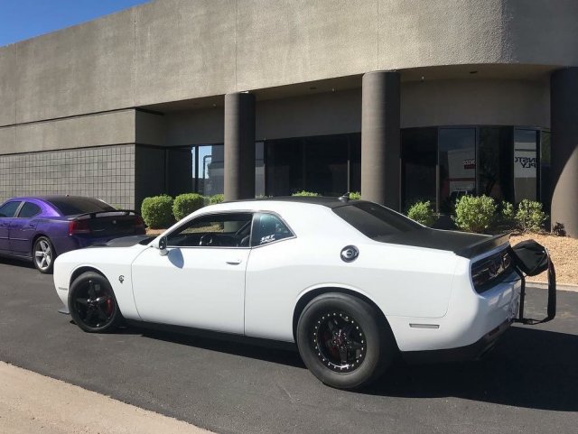

Depending on the wheel backspacing you may have to use short swaybar links. That is no big deal, they are cheap and easy to install. I would not give up the added big tire choice (315/50-17) to save the cost of short links. You need as much tire as you can get on these things. View attachment 96992
Thank you. Bad looking machine and I see that you have the 150-mph required chute.
29,394
130,582
Marc has much more experience than I do. I just switched to the 315 50R 17s this week after running the 18s for 3 years.
3,284
10,426

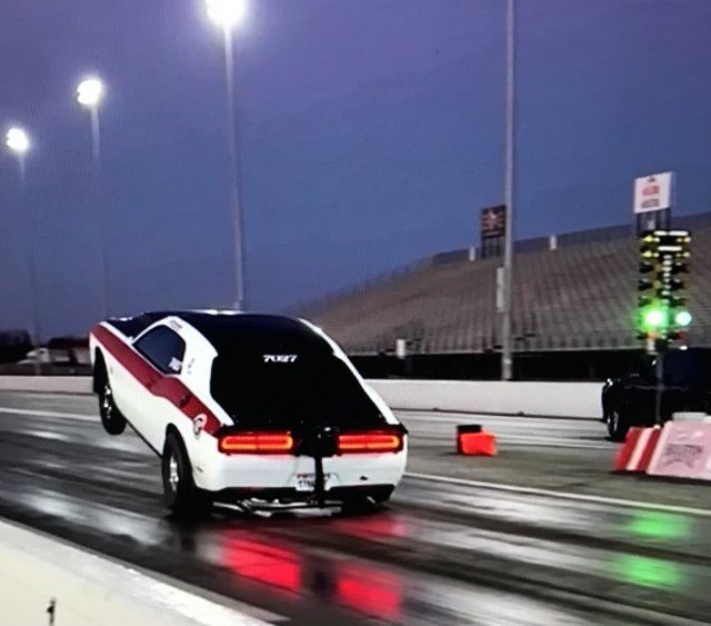

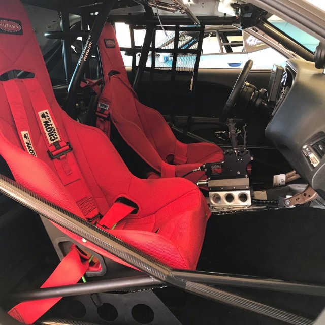

Haha. A little more than that at this point…. 433B8EF0-EC49-493D-8F62-1504486B8BC8.jpeg 417C2DAF-48B0-4CFD-8EFA-E63726DD9FEB.jpeg
