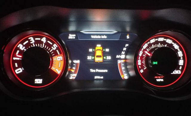

Ok probably a stupid question but I can’t seem to view the tpms screen in vehicle info . On my scat pack it was the first screen that popped up in that menu . 2016 Hellcat .. I know there are added screens for boost , inter cooler etc .. but thought it would still have this screen

Yes so I’m in the 2. Vehicle info menu , if I scroll using right or left arrow keys I get the different screens coolant temp, torque , hp, oil temp , trans temp etc , boost gauge etc ( I forget the order ) but no display of the tpms screen. Maybe I’m looking in wrong place ?

TPMS is the first screen in that particular menu. (Info)
If it's not there, that's strange

Yeap that’s what I thought now I’m concerned the system has been deactivated. I looked for a Tazer maybe previous owner had one but haven’t seen anything. On my scat it was the first screen under info . I thought about disconnecting the battery or not sure if there is a fuse I can pull :unsure:

Very bizarre it is NOT there... not sure what is going on. I have the following (and not in this particular order persay after coolant temp) when I scroll down from 1, to 2. Vehicle info the first screen I see under 2. is Coolant Temp, Trans Temp, Oil Temp, Battery Volt, I/C Temp, Boost, IAT, Oil Life, engine Hp, torque. I seem to be missing the TPMS screen and Top Speed (assuming top speed is under Vehicle info as well) I am going to try calling Dodge today.. I was going to disconnect the battery maybe something just needs to reset not sure. I have no TPMS warning light and car has stock tires and wheels. Very puzzled o_O:unsure:
