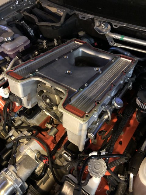

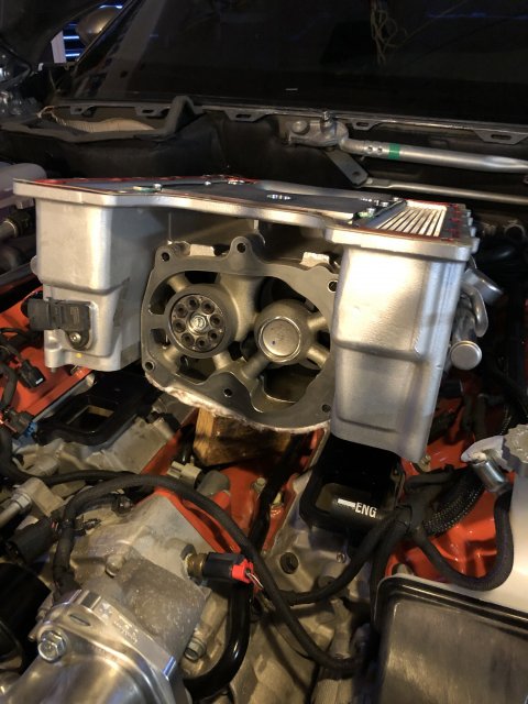

I decided to finally do a 2.85 TBA Machine pulley ( Thanks to Todd owner of TBA Machine for a great deal ) , F1 1000cc injectors ( Thanks to Keith owner of Fuel 1 for a great deal ) & have it retuned. After the Track Rental day a couple of weeks ago & my best time was 10.241 on stock boost, I figured that I have just about got the most of stock boost with my set up & I wanted a little more to run 10.0's & maybe high 9.'s so here we are. The install went pretty smooth after watching a lot of different vids on it & @Speedy's vid on his install, good info !
Got the retune yesterday at Peitz Performance , job well done to Alex ( owner & tuner ) & the whole shop !
It's a Mustang Dyno which will show a little lower readings vs a Dynojet Dyno, but it made 732 hp / 688 torq. - 93 octane tune. If we don't get rained out this Friday ? I'm excited to see what # it will run at the track , to me that's what really matters.

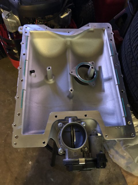

Look how purty the underside of that S/C lid is... 'Damn near eat off of it...

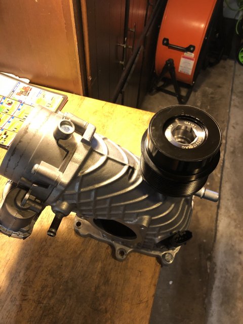

Congrats on the upgrade, the install is really pretty simple once you get in there. I've not heard of the TBA pulley but it appears to be decoupler like the Litens?
4,981
9,436
Thanks Speedy, the TBA is not a decoupler pulley , it the hub is octagon shape , as well as the pulley & does all of it's driving force with the hub center on the pulley center , the 6 screws just hold the pulley on the hub, hope that made sense. I went with TBA over the Litens or Metco pulley bc of cost , design & I already have my lower stock damper pinned.
It would make a good ice cream bowl. :LOL:

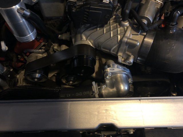

Really nice looking. That's the factory snout and elbow, just with the new pulley, right?
Thanks & that's correct.
