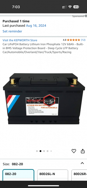

Lighter is better. I ran the amazon one for about a year and it completely discharged maybe from the cold? Also, I had to replace the starter shortly after :unsure:
Which one? What'd you replace it with?

I got this one. We had a thread on it a while back.

Same one Kepworth, went back to agm. I'm not sure the high cranking amps are good for the starter, like I said I had to replace mine. But then again mines a 2015 with 54k miles so who knows?
Higher amps will not damage the starter. I had a regular battery in one of my cars over the winter that was parked in a garage but not heated and it killed the battery. Was only 2 years old. After that I never leave a battery outside, I always pull it for the winter.

You had one of the lithium batteries?
I currently do have a lipo4 battery since 2021. The battery I was talking about was 20 years ago. Cold killed it so why I don't leave batteries in my car over the winter
