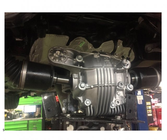

I put up a picture here Bull if you don’t mind draw two arrows to where you are saying to place the pry bars.
thank you sir.
the write up I linked suggests To only use on pry bar. It sounds like your method is a little more efficient/safer.
14,590
44,754
One one the front side, one on the rear, so one one either side of the axle.
