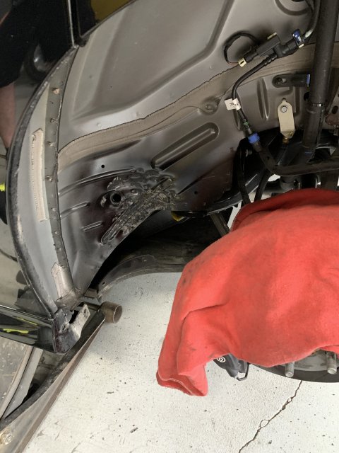

To add, make sure you get the correct offset for your wheels. Mine were ordered incorrectly and we had to beat the living daylights out of the finder wells to make the Weld S79, Mickey Thompson 315/50/17 fit.
This is just the first phase of beating the finder well. After we beat this area for 30m, I should have taken a picture, but didn't. But the entire rear of the finder well was beaten back. To include the front of the finder well needs "massaging".
One last thing: if your shop has an air hammer, please use it. That 8lb sledge hammer...SUCKS!!
