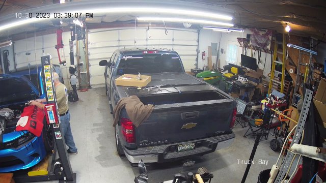

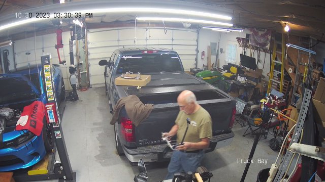

Could not see any thing on how to take it apart. So I stole my wife's compact mirror and used a flashlight to see the damn clip you push in on to release the wiring. Some engineer designed this upside down and you can’t see how it is held together. You’ll see me in the pictures where I look like I’m humping my engine to get my hands around the supercharger. But hey, its all good. Have a laugh.
But I did it and saved a few hundred dollars.
Included some pics for laughs and comments…pictures are from 2 of my security cameras
