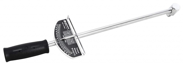

Never needs calibrating
But my bad shoulder, shakes & blurry vision make it challenging
