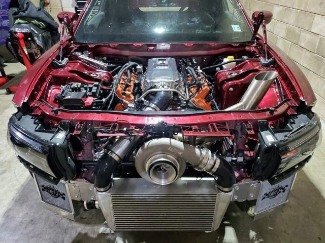

Timely thread...I saw a picture of a Charger with what looked like a turbo and supercharger. Been sick so forgot to post picture. Never saw that before.

Here it is...
Looks like turbo feeds air to Supercharger? Kinda of cool.

Unless I'm missing something that looks like a BIG ASS turbo going into a sheet metal intake. Unless they put the blower on top and its out the hood by a mile. That is insanely big and serious looking. Where did you catch that?

Was on Facebook by Ripatuned.
