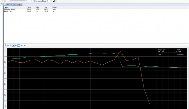

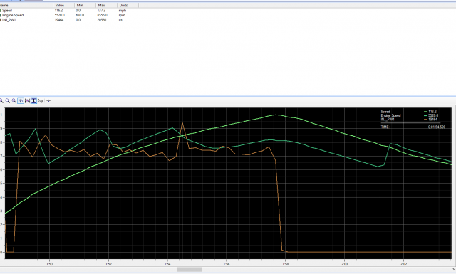

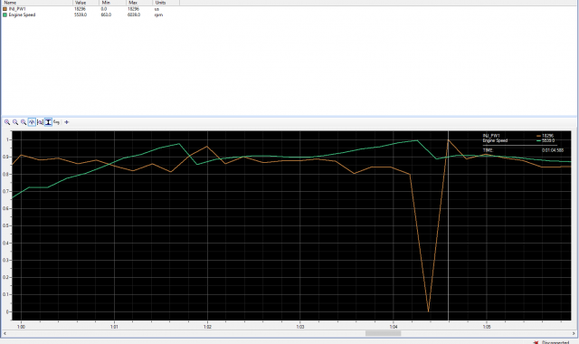

A few weeks ago on the Facebook group there was a lot of discussion on if Demon injectors are enough. There were a few pretty well known tuners strongly saying not to do it and a lot of people saying to do it. I choose to go with Demon Injectors for the price point and knowing sooner or later I'll want to go e85. I have found very little actual real world experience. I'm going to share a few screenshots and if anyone wants more information let me know. I'm not saying to do them or not. I'm just sharing what I have witnessed. The 89.5 is the highest I've witnessed and logged many pulls around 80%. I have logged two pulls over 85% and they are both listed below. I wish I could compare to FIC 775s. I am going to continue to closely monitor all year.
My Mods are 2.85 grip tech pulley with Demon Injectors on a 2018 Challenger with 26k miles on it. I will say most these pulls I did it 16 to 17 psi of boost even though I have a 2.85 but that's a different discussion.
Last weekend at the track DA was around positive 400 to 500 for this pull. I ran 10.5 at 133.4mph with a 1.65 60ft.
As you can see there was a quick spike which hit 89.5%
-400 DA. Just a pull while I was datalogging. Pull was to the top of 4th. Injector Duty Cycle hit 84.45%/
Da was less that a 1000 is all I have logged for this one. Pull was to the top of 4th. Injector Duty cycle was 77%

That's too high on inj pw. Playing with fire IMO.

It's definitely high enough where I feel every time I do anything I have to log it. That's why I stated this thread is for informational purposes and it's for people to make their own educated decisions. When I looked I found numerous people stating they were very happy with demon injectors. They provided no logs or details. I have a feeling I'm going to be changing injectors.

I bet the car is going in to torque reduction as a result of that inj pw. Factory limit at 6200 rpm is 13.7ms and that's way higher.
I think you are right. I uploaded this unlisted video you can hear right at 20 seconds when it shifts gears that it lost power.

80% duty cycle or less at WOT has been the rule of thumb.
