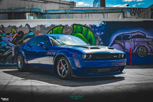

I have an extra set of WB wheels and had 315 Nitto 555r2's on them and just so awesome for street use. Just make sure Flares ect. are protected.
