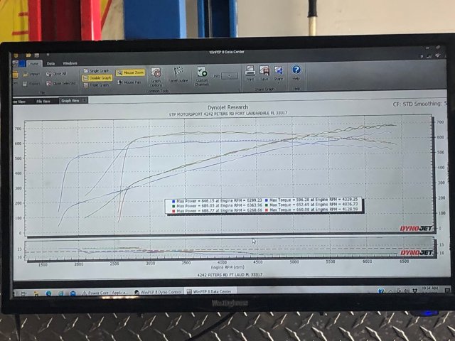

80 outside car was hot first pull 220 after we let it cool down and did much better im not disappointed

(y)Thanks for posting!

all were 6th gear pulls

Nice pulls for sure. Most shops don’t do 6th gear because of the wheel speed in that gear at redline is about 200mph, if I recall correctly.

I think those numbers are much closer to the 'norm' for an 80 degree day at full engine temp. They must'a put a Hellaphant in Eric's car and forgot to tell him. LOL. (I hope my '19 dyno's like that).
@800HP - @17% frictional loss puts you at @ 660WHP on average I would think.
Thanks for posting!

I'd be curious what SAE correction says. That accounts for the weather...supposedly but as mentioned it's just a number. See what it does at the track if you can. My stock Hellcat showed 670rwhp 650rwtq if memory serves. It ran 10.50s at about 132mph on a good tire.

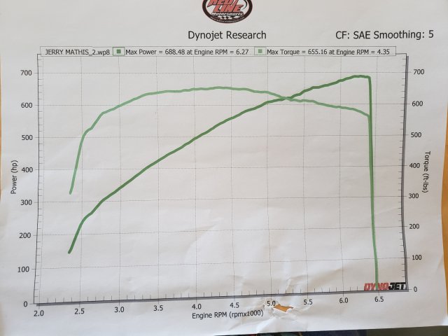

2020MOPARtyPowerAdderWinner.jpg FWIW, my 2019 Redeye made 688 RWHP and 655TQ at MOPARty i Bowling Green KY after a few hours of autocrossing and heat soaking, so these dynos seem to agree what these two Redeyes make. I don't know the DA, but the temp was around 80.
