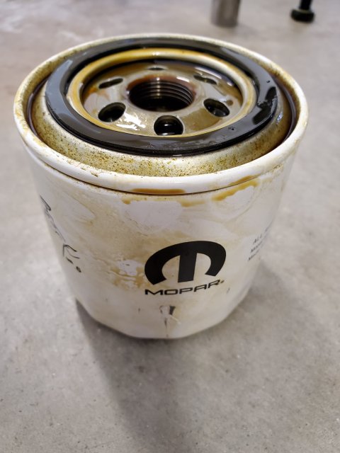

I've seen some questions posted about using E85 for those of you considering it. I posted a similar set of pics on the Geico forum, but for those of you wondering just how clean E85 burns and its effect on oil.
Here's another oil change on E85, 3100 miles on this change, look at how clean the oil is. For those of you that change your own oil, check the color of your oil after a 3K mile oil change and compare, notice how much more black the oil is on a pump gas engine oil change. I'm sending the oil off to Blackstone Labs again and should get my test results in about 2 weeks and I'll post the results again like I did last time.

Given this, why are you changing it so soon?

Recommended by tuner to change oil at 3k. Who knows how long it can go? My opinion is that it can go much longer but oil isnt that expensive so why take a chance?

And just because the oil is clean, doesn't mean that the additive package is still good.
Blackstone rules!

Agreed, but my last Blackstone analysis showed a TBN of 3.6 at the same 3K mile oil change interval on E85. The report says 1.0 is low and I don't know how many miles it would have taken me to get there. I also don't know what a typical TBN is for a gas Hellcat engine using the same PUP oil at 3k mile oil change interval, maybe the TBN would be higher, maybe the same.
Keep in mind, my car is a daily driver and often very short trips. I drive to work and home and around town here and there, but most of my trips are 20 minutes of driving or less which I would think would actually cause more wear than a highway driven vehicle.

Looks like oil will fall out of viscosity range way before contamination becomes a problem.

P.U.P. runs at the bottom end of this range "new", but you're right, that and the "TBN"
