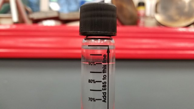

Two things:
Can someone post a picture of the Worms?
I've noticed that the stickers on the test tubes tend to be haphazardly placed on the tubes, meaning that the lines for percentages can tend to drift around (up or down). Does this seems like a problem, or is the variability not enough to be a problem?

Most of these guys are saying the performance diff is negligible between true E75 and E85 so maybe the 1-3% variation on the tube is nothing to worry about? Still would like it to be accurate though.
And yea, I'd like to see those "worms" too. interesting.

I'll see if I can find an old pic of a tube with worms and one with cloudy e85.
Your questions brings me to the second point I was going to make which is this: don't get hung up on the lines on the tube. They ar not %100 accurate. It is not uncommon for a tube to read 7-12% different than an ethanol content sensor. I interpret tube data more so for clarity and content of the specimen than for a specific content number.
