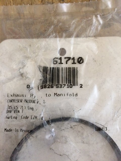

On the 6.2L, I can’t seem to find the part for the donut gasket between the headers and the cat down pipes. Does anybody happen to know an aftermarket equal alert?
I have the mid pipes off on my Trackhawk right now and I’m staring right at a gasket that goes there.
All of the OEM part call outs don’t list a gasket in this location.

I think this is what your looking for ?

Same part for both (L & R) sides.
You can get at O'Riely auto parts View attachment 30712
Dude. You are THE best. I’ve asked multiple forums and you are the only who had a part number. Fits like a glove.
Glad I could help, I had already been there & done that :LOL:
