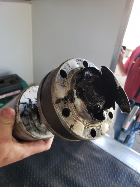

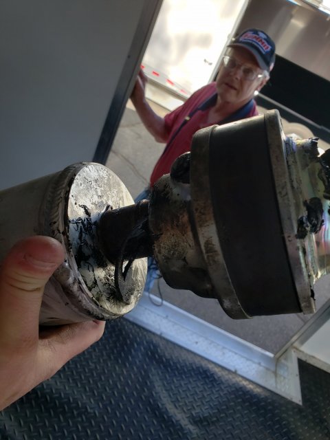

Decided the DA was just going to get worse so we were done. Jon is going to take some timing out for tomorrow so it will leave. We talked to the guy in the red Hellcat and Jon told him he had a driveshaft so he bought it and they paid us to install it. It blew out the front of the shaft, one of the ball bearings even fell out when Jon pulled it off. He has a 2.95 upper and a lower on it. He made an easy pass after we got it back together and went 10.1. A little later he made another and went 9.75@142. He said he has went way faster so I will have to ask tomorrow what he best is. DA had to be around 2500 at this point but at least the humidity was in 20's. They were from the Detroit area I believe

The car that broke also has a ported blower.

Even hotter today. Jon was working to just get it down the track by removing timing. I ran a 9.94@139 1st pass when DA was 2200. Played with timing some and then tried the 1-2 to the floor. Worked good 1st time I did it and ran a 9.98 in 2750 DA 1.48 60 ft.

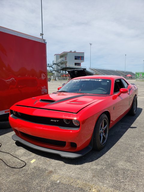

I had my my best 2 out of 3 with the Hellcat Jon and I put the driveshaft in. He was one of the 1st down the track and ran a 9.65 so it runs. It does have a 2.95 upper and a lower, jokerz full ported blower, springs, arms suncoast convertor, 315 beadlocks, 3.09's. They had just put a cage in it and it weighed close to 4800 so it wasn't light

Some pics of the driveshaft from yesterday and his car
20220513_091619.jpg 20220513_091622.jpg 20220513_134803.jpg 20220513_134810.jpg 20220513_141101.jpg
