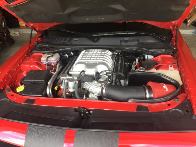

Hello everyone I am on the fence about what I should get to build for flex fuel. I have a 2016 challenger hellcat A8 I have already did a Bwoody race version heat exchanger
Jlt intake
Driveshaft brace
Dual oil catch can
Hhp 180 t stat
the reason I want flex fuel is a drive the car a lot in and out of town. I don’t want to worry about the fuel after it gets dialed in. I have not been to the track yet but is something I will evenly do as me and the cat gets better. How ever I do go to Mexico with friends more often than none. I do a lot of spirited driving if you my drift so I want something that can take a beating and keep going. I have been looking at the 2.72 griptec and the 10% lower and fic 1200 anything outside of that I’m open to
