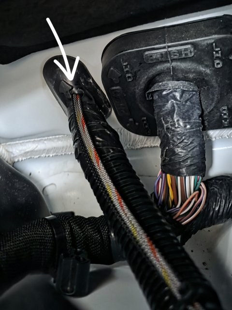

VERIFY EXISTING WIRING
To check if your Durango already has fog lamp wiring:
Option 1 (Harder):
  • Pull back the passenger-side fender splash shield and inspect wiring (see reference images).

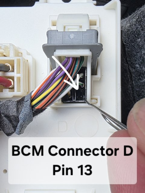

Option 2 (Recommended):

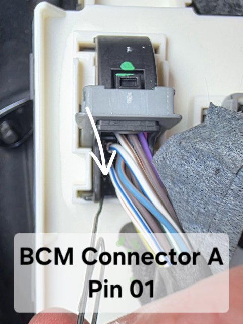

  • Inspect BCM connectors:
    • Connector A - Pin 01
    • Connector D - Pin 13
If fog lamp wires are present → No bridge wiring required

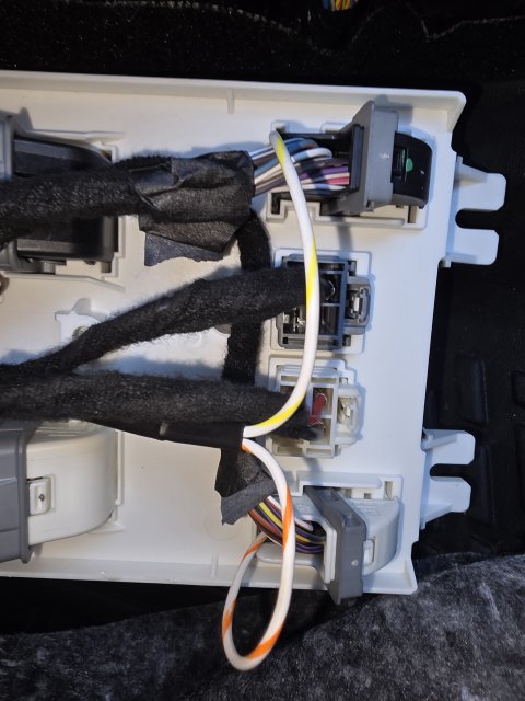

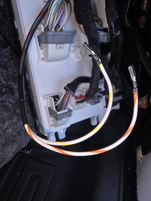

ADDING MISSING WIRES (BRIDGING)
Step 1: Disconnect Battery Ground
Step 2: Terminals Required
  • (3) Male terminals for Front End Module 16-pin connector
    • TE Connectivity 1718760-1
  • (2) Female terminals for BCM connectors
    • SNAC-A061T-M2.8
Step 3: Run Wires
  • BCM Connector A Pin 01 → White/Yellow (Left Fog)
  • BCM Connector D Pin 13 → White/Orange (Right Fog)
Step 4: Route Through Firewall
  • Route both wires through the rubber firewall grommet into the engine bay
Step 5: Install Female Terminals in BCM Connectors
  • Locate BCM Connector A and BCM Connector D
  • Identify the correct cavities:
    • Connector A – Pin 01 (Left Fog)
    • Connector D – Pin 13 (Right Fog)
  • Prepare your wires:
    • Strip a small amount of insulation
    • Crimp the SNAC-A061T-M2.8 female terminals securely onto each wire
  • Insert the terminals into the BCM connector:
    • Push each terminal into the correct cavity from the wire side (rear of connector)
    • You should feel or hear a click when the terminal locks into place
  • Gently tug on the wire to confirm it is fully seated and locked
⚠ Important Tips
  • Do NOT force terminals—if it doesn’t click, it’s likely misaligned
  • Verify orientation of the terminal (they only insert one way)
  • Double-check you are in the correct connector and terminal location before inserting

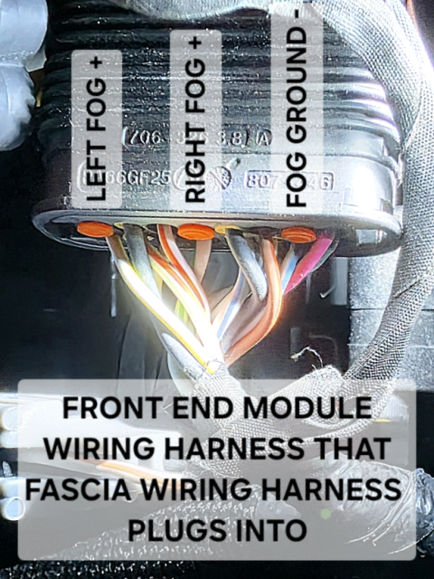

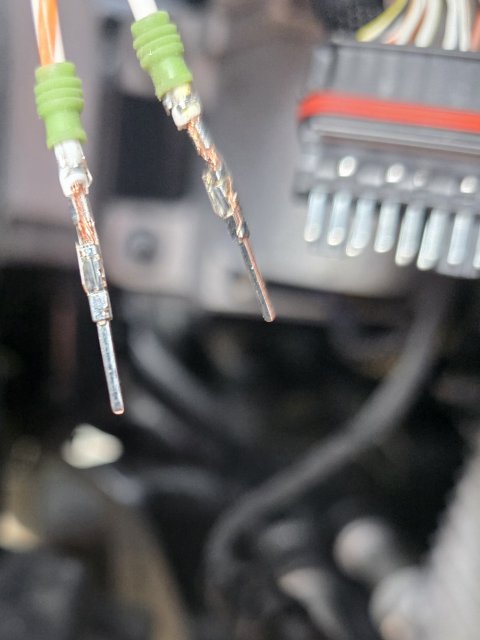

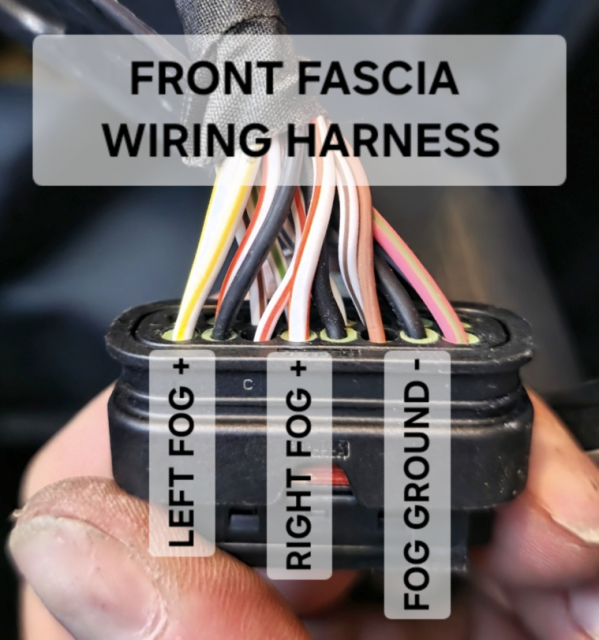

Step 6: Pin Front End Module (16-Pin) Connector
  • Locate the 16-pin Front End Module connector (body-side harness)
  • Identify correct orientation:
    • View from the wire side (rear of connector)
    • Lock tab facing downward
    • Pins numbered left → right
  • Identify the required cavities:
    • Pin 1 → Left Fog (+)
    • Pin 4 → Right Fog (+)
    • Pin 7 Ground
Prepare the Wires
  • Slide a 1-967067-1 wire seal onto each wire before crimping
  • Crimp the 1718760-1 terminals onto the wires using a proper crimp tool
Remove Cavity Plugs
  • Locate the three orange cavity plugs in Pin 1, Pin 4 and Pin 7
  • Carefully remove them using a pick or small tool
  • Do not damage the connector housing
Insert Terminals
  • Insert each terminal from the wire side (rear of connector):
    • Left Fog wire → Pin 1
    • Right Fog wire → Pin 4
    • Ground wire → Pin 7
  • Push firmly until you feel/hear a click
  • Lightly tug each wire to confirm it is locked in place
⚠ Important Tips
  • Double-check orientation—this is where most mistakes happen
  • Do not force terminals; if it doesn’t click, it’s not aligned correctly
  • Verify pin locations against your fascia harness before final assembly
  • Ensure the wire seals are properly seated in the connector

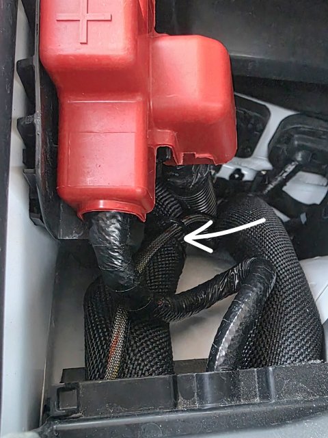

Step 7: Ground
  • Ground the black wire to the factory ground stud on the frame rail near the 16-pin connector

Thank you. I installed them on my 2024 AlcHEMI Edition Durango using the same parts list, BCM fog lamp wiring was present in the AlcHEMI. When I installed them on my 2026 Hellcat, they didn't function, which left me scratching my head. The instrument cluster was showing them activated, but the fog lamps wouldn't light. So after some investigating, I found there wasn't any fog lamp wiring in the harness from the BCM. With the wiring missing, I was also worried that the hardware inside the BCM may also de-contented. AlphaOBD identified the BCM pins for me, as it was one of the program settings that needed to be changed to activate fog lamps. I then used a multimeter at those pins. When I pressed and depressed the fog lamp button, voltage registered and dropped out at those pins, which meant the BCM still had the proper internal hardware. I then ordered the matching wires and the correct crimp terminals. While I was running the wires, I thought it would be a good idea to document everything and post a step-by-step guide for others to use.
