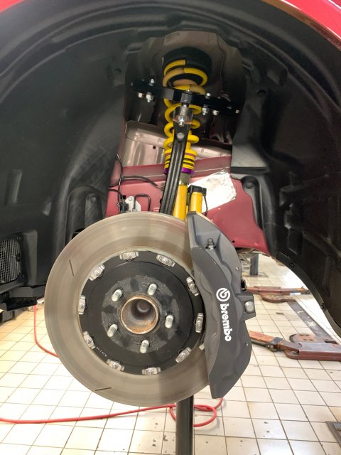

I switched to Z26 brake pads on 2 different sets of rotors and both of them developed hot spots . Is there a brake pad that is won't cause hot spots on ther rotors ?

Those were my original hellcat rotors . My new race brake rotors are starting to do the same and I want to stop it before it get too bad .
I guess stopping at 140+ mph on a short shut down area is not good for the Z26's

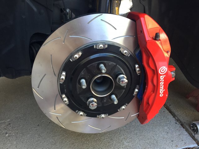

Also went with DBA rotor rings and re-used the OE hats. They’ve been great for street and track both. A little over $800 for the pair if you do it yourself. Easy not to mess up since they’re non-directional.

I have Demon performance rotors on the rear and race brake rotors up front . I have Z26's on all 4 corners but will be replacing them soon . And yes those are demon calipers on the front .
