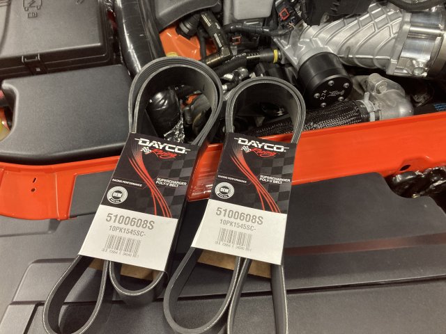

I use these belts, they are made for supercharger use, they hold up well and I turn my superchargers pretty hard, used same one on my whipples as well when I was running them.

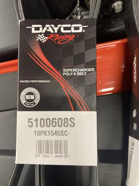

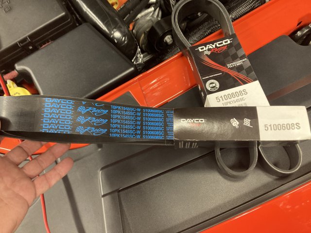

Are @16GoManGoHC2 for stock blower pulley diameters?
That size belt fits with using the AAD Idler pulley in center mounting hole with +10 lower with that 2.74 Satera Griptech prepped upper with 1/2” thick FI Insulator Spacers. Blower making 25.5 psi of boost very little belt dust.
Also fits +10 lower stock upper and no spacers or idler pulley.

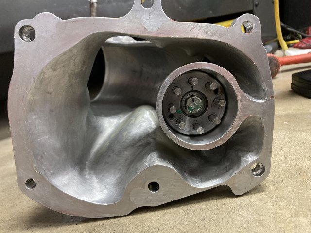

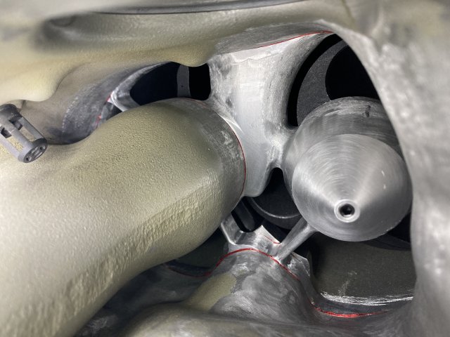

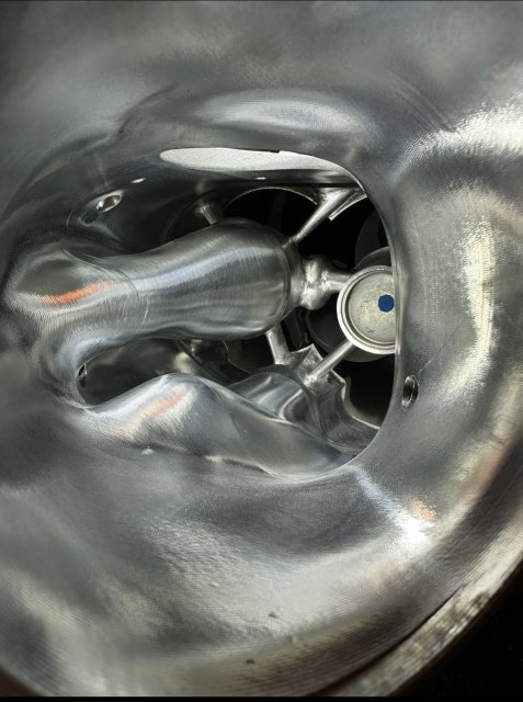

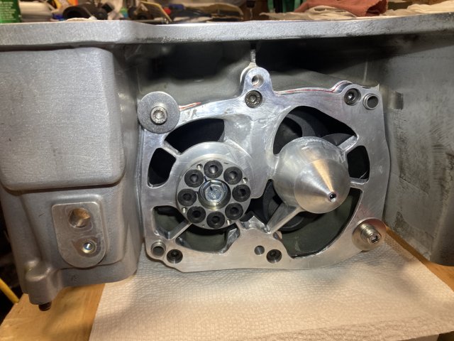

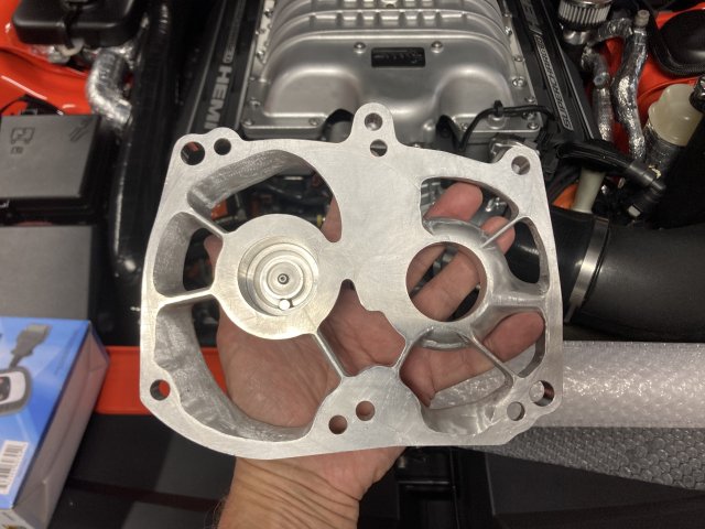

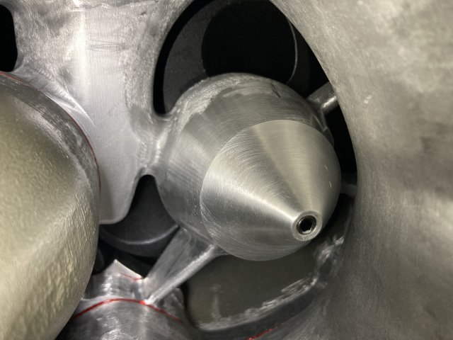

Yes, 25.38 to be exact with my hand ported 2.7 snout and 105 TB, has my custom billet 2.7 inlet plate with oiled bearing, the thing is singing but staying happy so far!! Have to try the SDG snout and NW 108 TB someday.

Man that’s moving air! Wonder what mine makes no (just a dinky 2.4) pretty sure I’m maxing out the stock map sensors
Yes, seeing almost 2300 Aircharge and 2.82 PR

So will that belt fit with a stock idler and 3.10 upper pulley?
3,616
8,496
No idea with any certainty. How I get close for a belt size as I put a string around all the pulleys and then put the tensioner in about the middle of it travel and match the string up, put a mark on it and then measure its length and see what belts are available in that size
The correct number for the Dayco belt same size as stock is Dayco Racing 5100580S. I ordered it from Summit. I think it was $46
57,256
195,514
The 100 at front of number means it is a 10 rib. 579-580 would be a stock belt. Find a belt between 575-578 for a 3.10 pulley but I also wouldn't even bother with a 3.10 pulley. If you are changing the pulley you should go smaller because once you change it, you will again.
