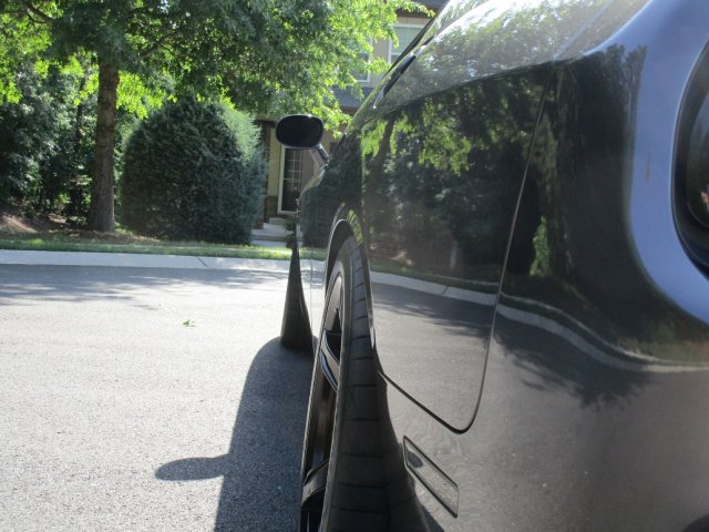

Anyone have some pictures of the 10.5 x 20 wheel with 305’s on their Challenger?
Let me know if you need more angles.

Those look like ECSs, did you need spacers to fit? I have PKAD HR5 10.5s with 25 mm offset, Cont ECS 305/35/20 on rear of 2017 ChallengerHC.
I did not use Spacers. My rears are PKDesign HR5 10.5" Hellraisers with the same tires as you. I did not need to use any heat, but the inner fender well is slightly warped from exhaust towards the tire....no rubbing, but a very tight fit. I imagine I will at some point have to use heat to pull the inner away from the tire....
Looks good, do you have a side angle of the car? And have you lowered yours?
I used Eibach Pro's on all 4 corners to lower.

I’m putting that setup on my rear tomorrow. Any rubbing issues?
Those look like ECSs, did you need spacers to fit? I have PKAD HR5 10.5s with 25 mm offset, Cont ECS 305/35/20 on rear of 2017 ChallengerHC. I trimmed liner, heat gun too and still tight enough that I use 1/8" spacers. All good now with that.
so you had to run a 1/8” spacer.
I am not sure it was mandatory. It was very close and I thought I heard a few random rubs without. So for peace of mind i put the spacers on. The wheel/tires still sit great at outer edge, and no issues of any kind with spacers on.
No sir...So far so good. :)
