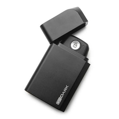

That had me considering the GoDark Vault key Fob case. It's double the price of the pouch at $50 ea, getting away from the soft pouch design:
The GoDark Vault - Key Fob Faraday Cage
https://godarkbags.com/collections/...t-key-fob-faraday-cage?variant=44151447781589
But before I ordered it, I thought my keeping the keys attached to the FOB while it was in the pouch had possibly contributed to damaging the signal blocking liner.
So the bottom line is, I had an extra unused pouch that I will now test out without the keys attached. I'll keep you posted ...
