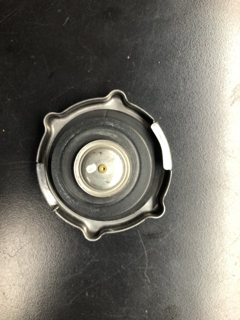

The tank cap may be bad. When I changed the fluid in mine cap did not reseal, system wouldn’t not pressurize and splash would come out the overflow vent. Cap does not seat on center and if not in right spot the compressed gasket does not reseal, look at attached picture. A new cap fixed my issue

Tnx for the info. Got car back from dealer friday. Diagnosis was faulty cap not holding pressure. $25 replacement, no other charges. So far, no leak or overflow. Fluid level normal so far.
