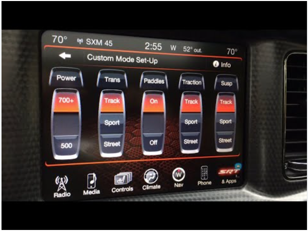

I didn't realize there was a 700hp mode to switch to. I will look at performance pages and see if i can do that
Old style display, but yours should have something like this. Left button might be on 500hp?
