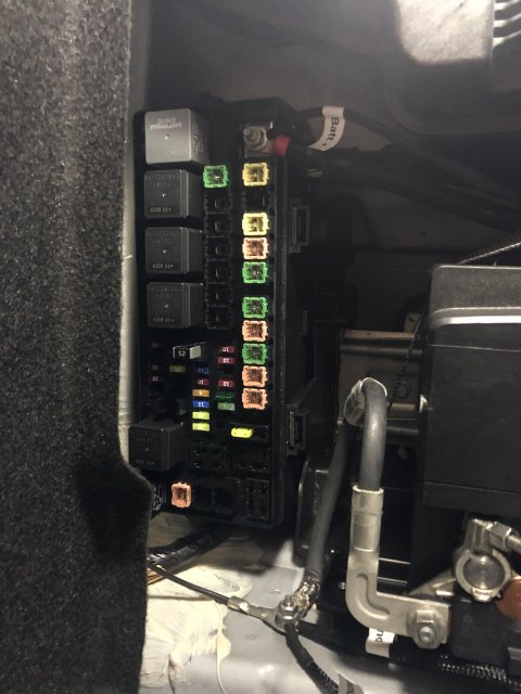

power on corner post of fuse panel
2 grounds on factory post beside fuse panel

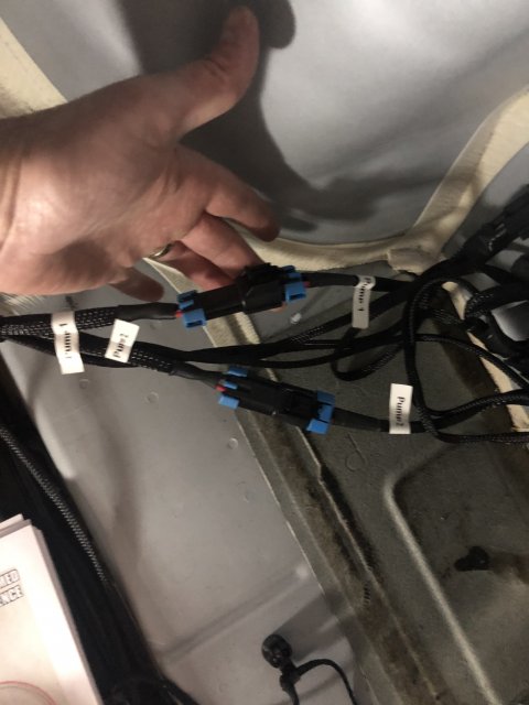

Fist and Second fpdm and y harness only go together one way I’m pretty sure

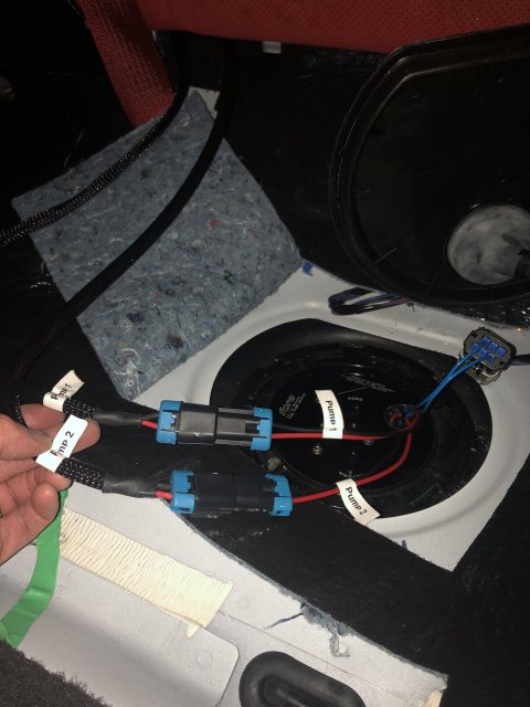

pump 1 and 2 wires clearly labeled all the way to the hat.

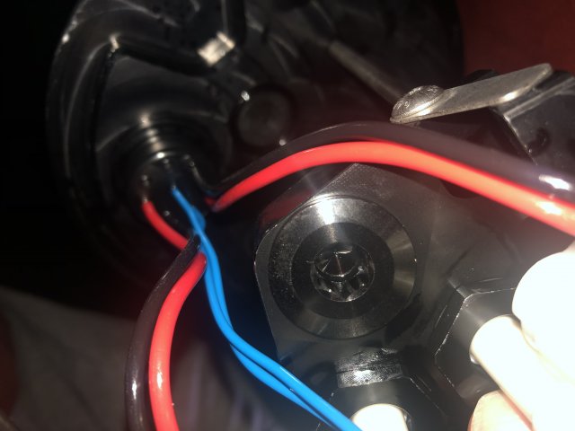

wiring connector on the hat
am I missing anything?

I stuck my ear right to the hat with my wife doing key cycling and they’re definitely coming on but I can’t say I hear any fuel moving?

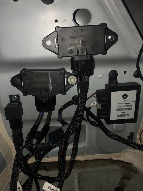

Checked the wiring again. Seems to be correct. Excuse the mess, I didn’t secure it all down yet because I wanted to make sure it was working first. The primary fpdm is the one with white line on it.

Looks similar to what @Speedy! installed. He has a video on youtube that may help
I've seen both parts several times. Great videos. He did real good job with the wiring. Maybe he can chime in

Looks like you have a plug and play harness... different than what I’ve installed in the past where a friend of mine had his connectors wired backwards. So, you’re probably right, they only go 1 way with these.
