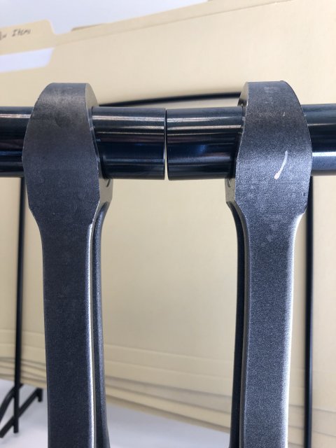

If I'd had time I'd have pulled all the pistons out, but I was pressed so just boxed it up and shipped back to Mopar for core once we found the one disintegrated. I received some piston/rod assemblies from a performance shop (3 assemblies) from a failed engine. They didn't give me details on what failed, but @16GoManGoHC2 has experience testing parts failures so I shipped two of them to him to do some catastrophic tests on out of curiosity. I also sent him what was left of my #7 cylinder piston. Piston tops looked ok on the three test subjects, but had some scoring on the sides.
Turned out the piston assemblies I sent him were bent (granted not from my motor but AJ has mentioned bent rods more than once now). I kept one for myself as a souvenir and when Mike told me the others were bent I checked the one I kept, sure enough it's bent. The piston from my engine exhibited very similar wear characteristics on opposing sides as the assemblies I provided with bent rods. Mike's experience suggests the rod failed and caused my piston to fail. All just educated theory though really.
Had another shop reach out to me last week. Three Hellcats and a Demon all broke #7 and his analysis showed rod issues so they now recommend a piston/rod upgrade after 800rwhp.

I've been working with Gen III Hemi platforms for about 10 years. I'm not a professional shop by any means, but have been around enough to see patterns and learn from those that build these engines. On the 5.7 and 6.1 HEMI platforms (and especially the 6.4), the ring lands were a problem. The rings would expand due to heat, touch end on end, and with no where to go would bend up and usually snap off the intake side of the piston above the last ring land. I've seen this happen A LOT on stock engines with boost added. One shop disassembled a stock 6.1L motor, filed the rings to enlarge the gap, and re-assembled the stock engine and proceeded to run some very good numbers on boost, but that's the only one I ever heard of doing that. I had a 6.0L stroker built from a 5.7 with all forged good parts and raced that thing for 9 years trouble free and it's still on the road today. I made that decision based on all the 5.7L engines that were blowing up at the time with boost.
I say all that to say if the rings were a problem in my case, the opposite end of the piston broke. The skirt sheered off almost cleanly right around the wrist pin and I didn't see any signs of issues with the top ring land.
After Mike (16GoManGoHC2) did some analysis, it looks to him like the rod was bending, put add'l stress on the wrist pin area, and snapped it off.

If the ring gap is closing, the ringland would be failing and we would see that in the piston and the cylinders. I don't know that it has been reported yet, but it had to have been looked for - certainly by anyone with experience with GEN3 HEMI motors that have been plagued by ringland failures for years.
The ring lands, groove bottoms and ring but ends where one of the first areas I inspected on samples Speedy sent me after looking at his failed piston. Nothing funny seen strange on the ring area of what was left of his piston nor on the 2 samples from a different Hellcat engine he sent me.
I was going to do a tensile strength stretch until failure test on the assemblies to see what failed first the piston or the rod and where from RPM induced centrifugal load as the piston changed direction between exhaust and intake stroke. My first theory was heat and the pistons seizing in the tops of the bores from being over heated and their bottoms being pulled off but after inspecting what Speedy sent me and taking them to a guy who has handled more pistons in his lifetime then most likely 90% of any other engine builder out there he pointed out bent rods on both by just a 10 second glance at the piston portion of the assemblies and not once looking at the rod, and he was right!!! Their both bent alright, in the wrist pin bore, both in the same plane, axially with the pin, firewall sides of both pistons canted down.
