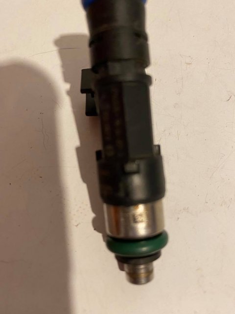

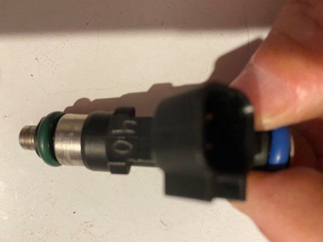

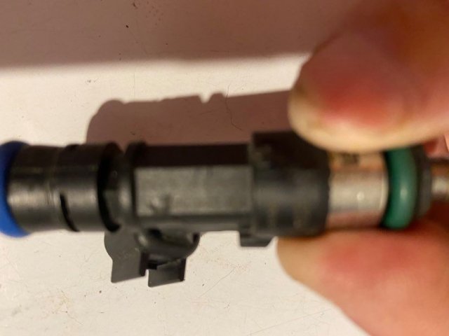

I bought my hellcat used.I have tried to find out if the injectors are stock or not.I looked pic. of stock injectors and the ones in my car look somewhat different. I have took one out but cant find any number's that weren't very clear and the ones I did find searched and found nothing.So with all that being said is there a way to find out? I mean if was to take them off and ship them off to be cleaned would they know?

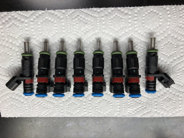

pic. of stock same yr. model just dont look the same to me

pn 68170238AB is visible on most. search it alone in your preferred search engine, you'll should get plenty of results.
Edit: unless they're chicom counterfeits, those are the OEM HC injectors
